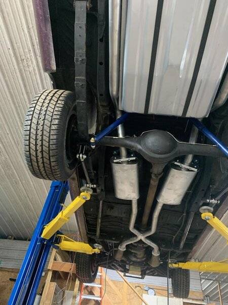

Question 2.5" or 3"? Put a 3" TTI header back system with brand X headers. Fit great, I bought an H-pipe only issue was needing to add to crossover pipe. Crossover pipe was 2.5" went to parts store bought pipe slip over one end and go inside other end. X- pipe might not be as easy but don't know.

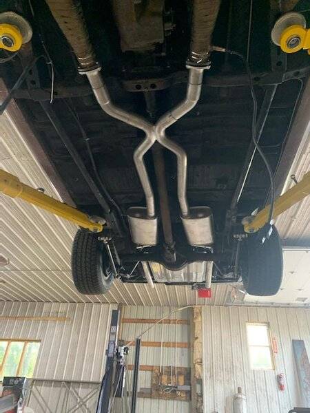

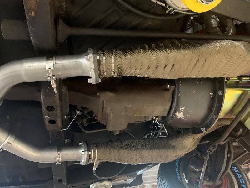

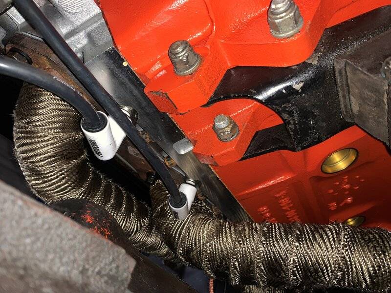

FWIW I would go as far as to blindly recommend the TTI system for your application. I have never owned the year in question but the several TTI Systems I have installed on 68-72 b bodies leaves no doubt as to the consistent quality of there products. My latest set of TTI's were installed on a 69 Superbee with a 440-512stroker and a 4 speed with a scatter shield Headers are 1 7/8 long tube headers and full TTI 2 1/2 x pipe system with Dynaflo super turbo mufflers. I had Zero clearance issues anywhere and of note is that my headers are wrapped and I still have ample clearance.
