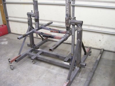

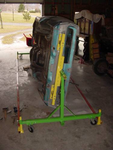

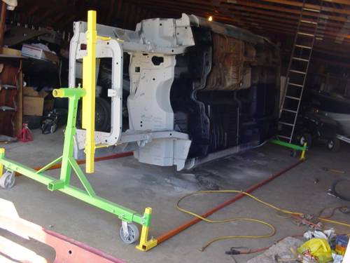

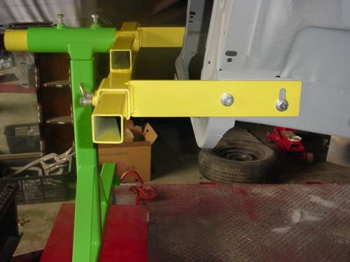

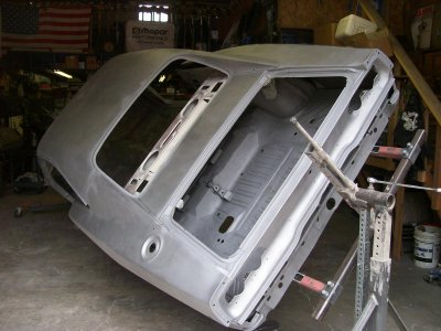

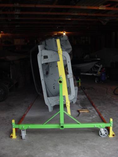

Ok, here's some pics of my rotissierie I built and modified over the years, first two iterations I didn't like, modified them to what I have today.
This is back a few years...
[/IMG]
Back in 2008...
[/IMG]
Current mods...and currently near perfect, mounted VW Bus, GT500, E, B, and A Bodies, El Camino, Chevelle, Novas, and several Mustangs so far.
[/IMG]
[/IMG]
[/IMG]
