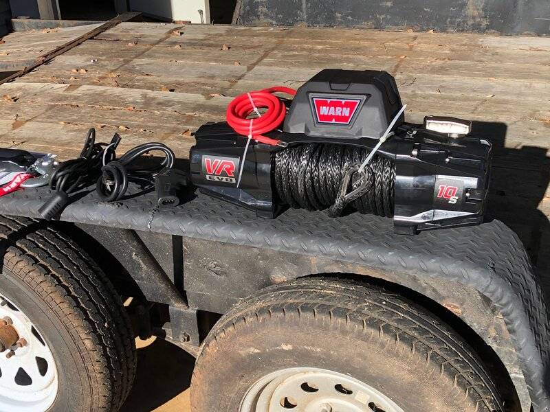

Update on an old thread, I decided to go with a newer Warn 5 ton winch with the synthetic rope and remote control. As I usually load old clunkers by myself and the wireless remote sounded like a big plus. The safety of the synthetic rope was also a factor in my purchase. Plan is to mount winch on a receiver type pan and make that mount on my trailer so simple removal is easy. Thanks for your opinions Guys, plan is to use it next weekend to drag a 69 Satellite that has been sitting in the woods for twenty years, out and get it loaded up. Got some snatch blocks for use as I m sure this body will have locked up wheels.

Just in case there are trees or other obstacles in front of the vehicle that is to be extracted, you may want to add two or more tree straps and an equal amount of shackles (which you should have for the snatch blocks already), this is if you can not get a straight line of pull. I hope this makes sense.
I carry four snatch blocks and many more straps and shackles on my Jeep. Self recovery is maybe number 2 in importance in my world of 4-wheeling.
Protect the synthetic rope from rubbing on metal/rock.
I guess that you know that your pull rating 10k lbs. is on the first wrapping of cable/rope on the drum.

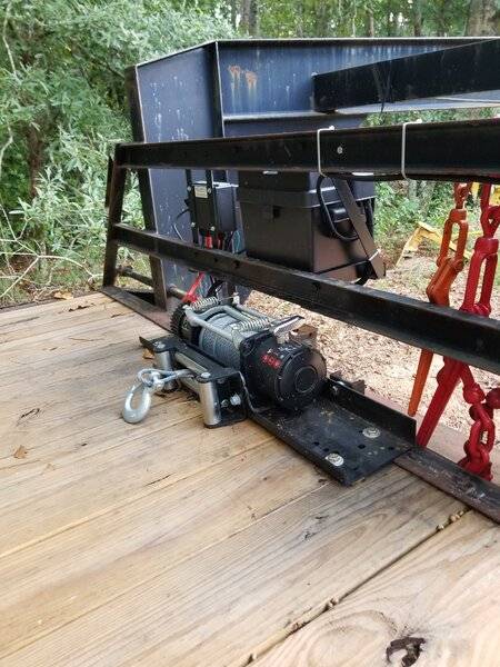

I had a HF 9000 lb one on my 12,000 lb equipment trailer that worked for years trouble free, so I bought the HF 12,000 lb winch and put on my goose neck last year with cable. It pulled this tractor dead out of the weeds with no issues. Only cost $300 on sale. Can buy several for the price of a Warn.
With a Warn you’re paying for things like cables and switches that don’t shatter in the cold. Most things work when it’s nice and warm and sunny. Most things don’t work when it’s dark and minus thirty. A Warn does.
