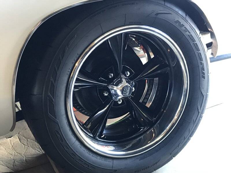

Curious to see if the 305/45/17 Nitto 555r2 s that I ordered are actually going to fit in the back of my 69 Bee with hotchkis leafs? Anybody have these on there cars? Photos ?

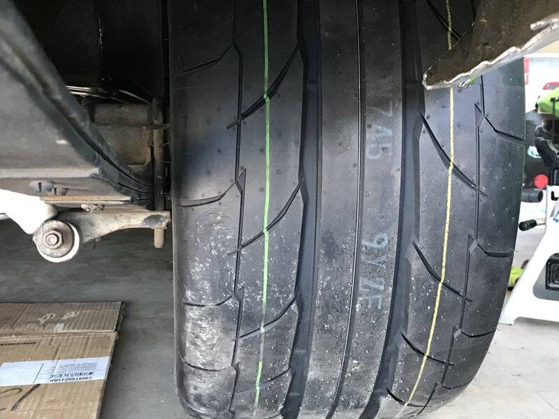

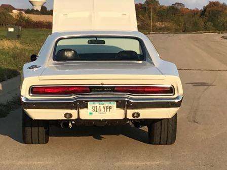

I run that exact tire on the back of my Charger. It does fit, but I will get occasional rubbing if anyone is sitting in the back seat (not bad). Not sure if it would fit in your 69 Bee. If I remember correctly, I went with a 5.25 backspace. In retrospect, probably should have gone with 5.5.
View attachment 1232348 View attachment 1232349 View attachment 1232351 View attachment 1232352 View attachment 1232353

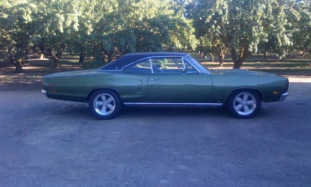

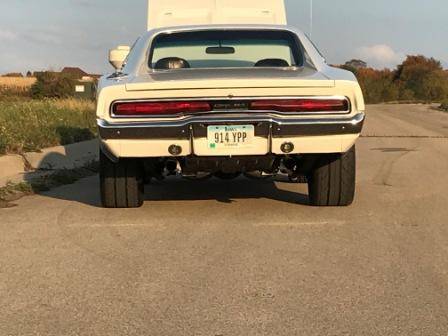

315/45-17 on 17 x 11 wheels
Full disclosure, no wheel tubs, stock spring location, it is close everywhere but didn't rub... Those are actually my wheels & tires on my friends Coronet R/T... My Coronet isn't on the road yet.... But I wanted to see how they looked & fit on his car... We drove it a little but not much so while they didn't rub I can't say they wouldn't rub if driven more...... Front tires I'd need to look, I think they a 255/55-17..
Those wheels and tires changed his Coronet from Grandpa's Old Dodge into a very cool looking muscle car...

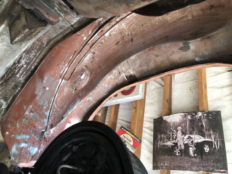

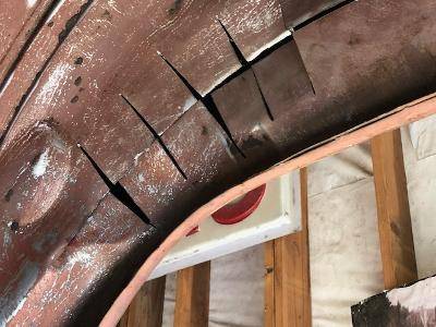

You can but you might have to raise the car to do it without having tire rub. The reason is that the wheel tub design is strange. You'd think they would have made the outer wheel tub to follow straight up alongside the quarter panel but they didn't. The tub looks like this:

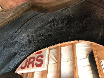

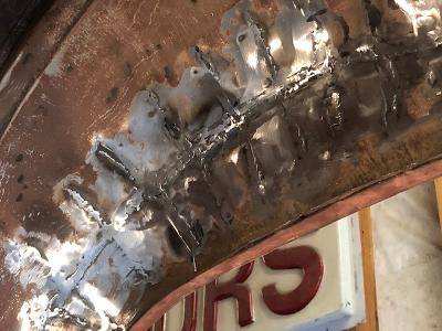

I did a NO $$$ fix on my "Jigsaw" Charger and plan to do the same with my other car.

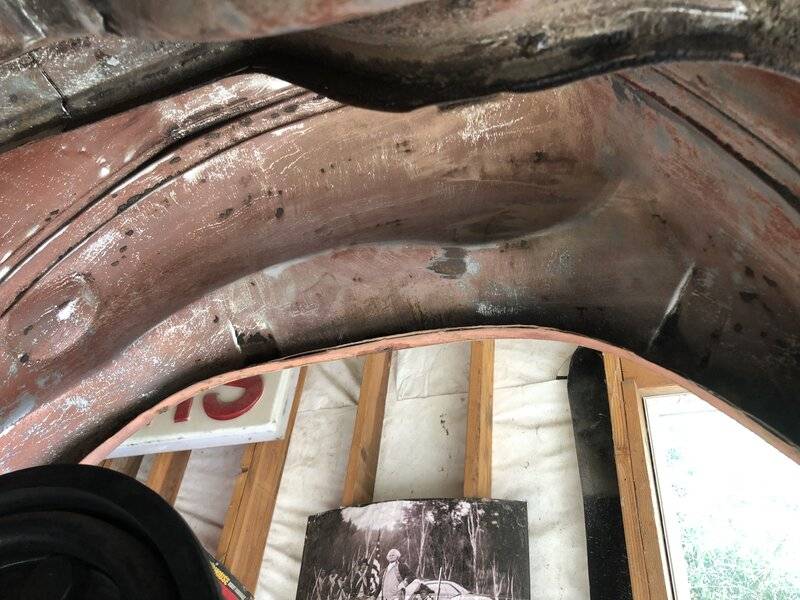

Along that ridge, I cut the tub using a grinder.

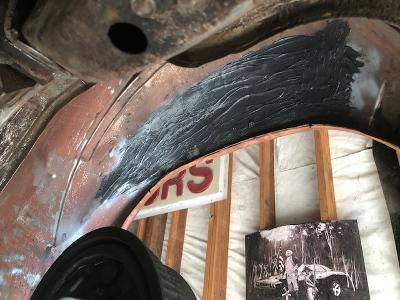

Then I made additional cuts and pushed the metal in.....It looked like football stitches. Welded it up....
Grind down the high spots, add some primer and seam sealer.....
Finish it off with some undercoating shot from a Shutz gun....
Now you can fit some W I D E tires in there without rubbing!
