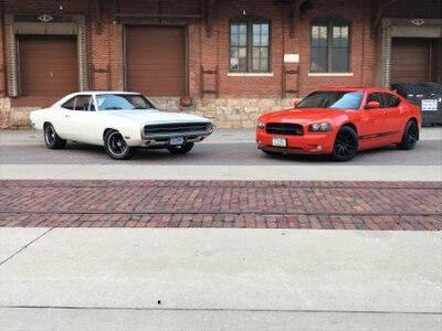

I run that exact tire on the back of my Charger. It does fit, but I will get occasional rubbing if anyone is sitting in the back seat (not bad). Not sure if it would fit in your 69 Bee. If I remember correctly, I went with a 5.25 backspace. In retrospect, probably should have gone with 5.5.

Thanks! The wheel I want comes in a 17x9.5 with 5.5 backspace. I get a tiny bit of rub over Certain dips with my 275/60r15.
I have a 255/50/17 planned for the front on a 17x8. What’s your fronts?

My fronts are the Nitto Motivo and are a 235/55/17. I don't remember what I went with for a backspace on the fronts.
