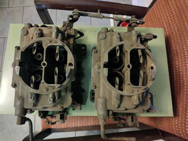

I have an Ultrasonic cleaner but I have gotten better results without it.
Just really hot soapy water, Scrubbing ( Very Little), and Aluma Brite.

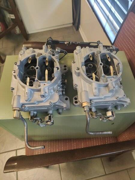

Here are the before and after.
Here is a link to the thread I post about it.
Carter AFB Hemi Carbs cleaned up.

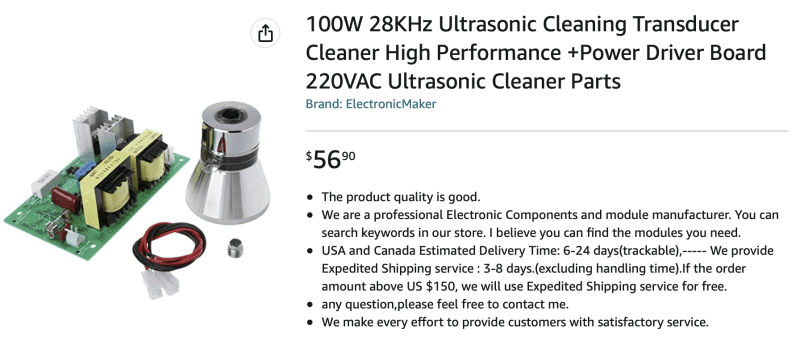

I watched a couple videos of large, home made ultrasonic cleaners. The vibrating parts can be bought and installed on a tank. I'm thinking a stainless tub from a wash machine or a rectangle box of some kind. Need 100 watts per gallon.
Do they have a version that runs on 110 volt?
Yes, I didn't notice the voltage when I cut it. The screen shot came from Amazon. There is a threaded stub to be welded to the tank and the vibrator screws to that. ...and I just noticed it is not 40 kHz, which the videos I watched claimed worked the best.

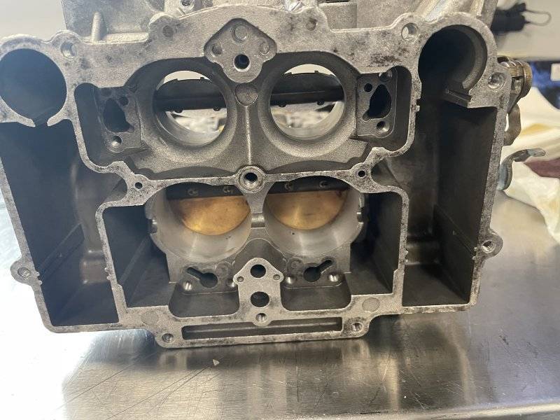

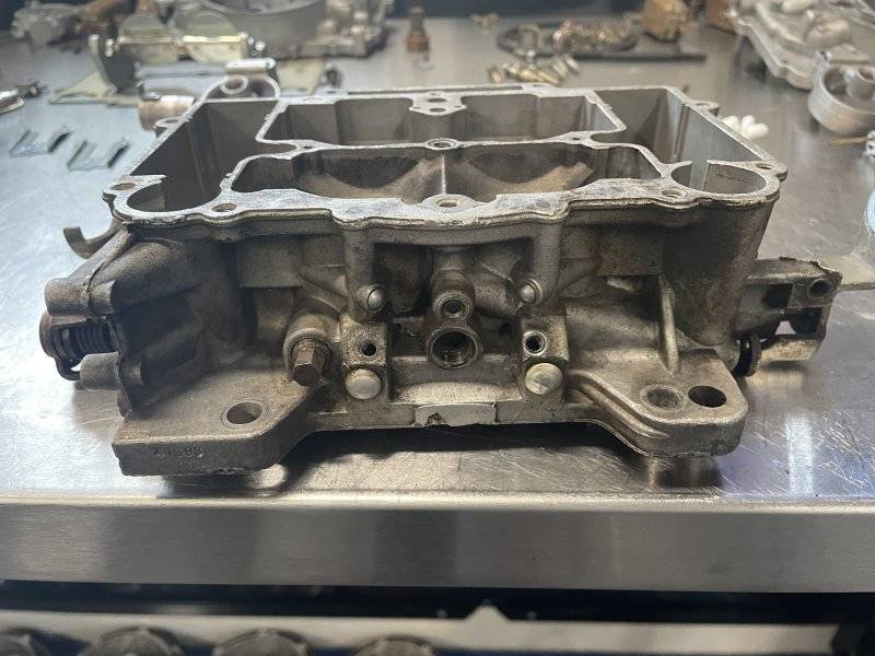

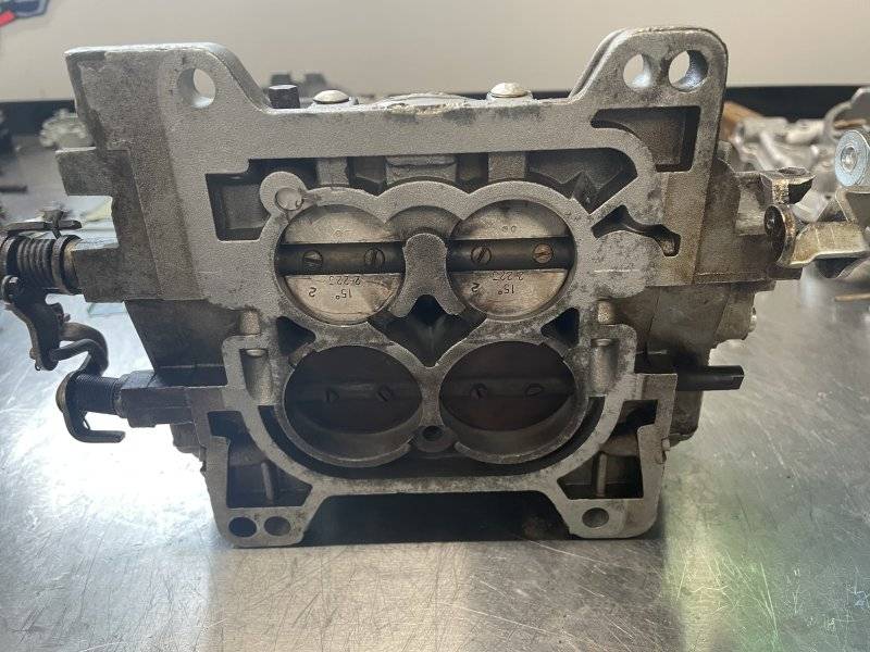

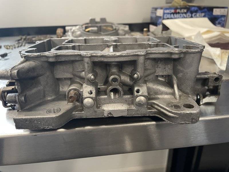

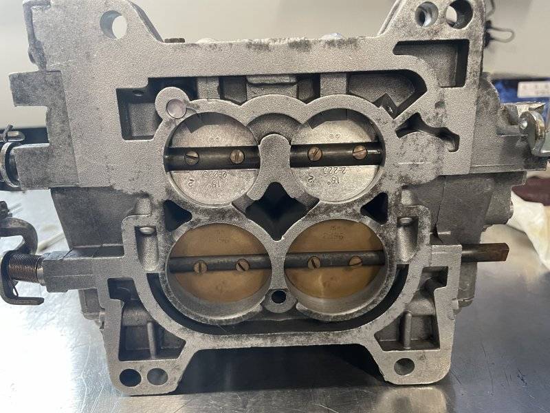

Here's what I just used on my Hemi carbs....
This is the before pictures of the front carb. The rear one was worse.

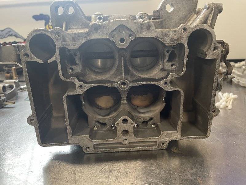

After soaking and cleaning with an old tooth brush and Q-tips.
