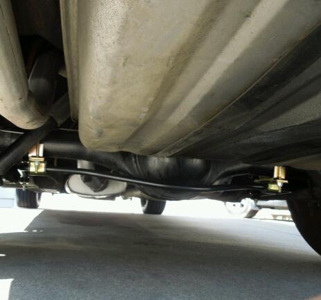

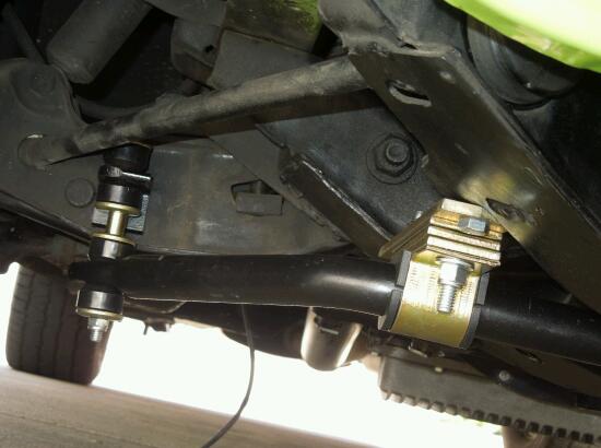

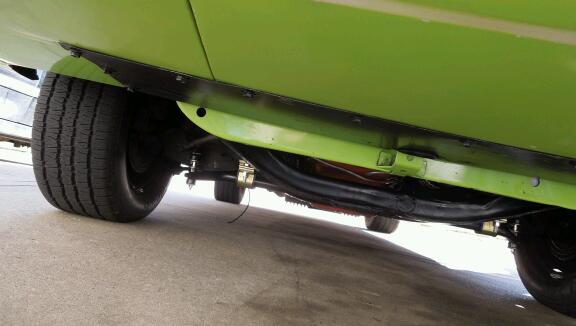

Again I run the firm Feel box (from steer and gear ) on my cars and it drives like a modern car , for the price of 275.00 - 325.00 you cant beat it . Throw on bigger sway bars and torsions cars and you will be happy .....
