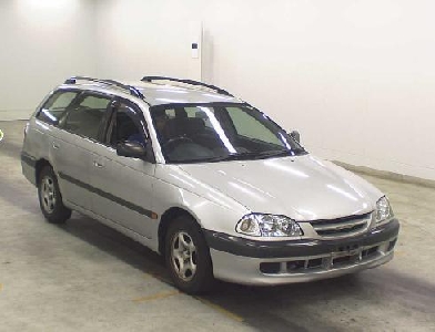

No mower blades on the family runner :) Toyota Caldina 2.0l ...similar to this one below
