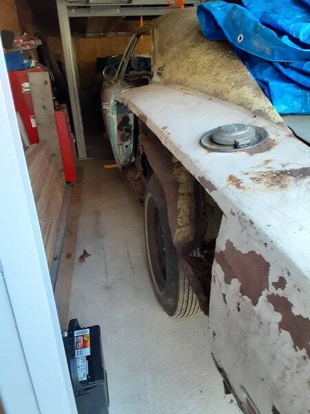

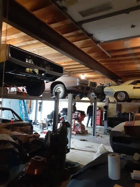

The rear quarters have been in my loft for 16 years. Someone had already started cutting off the drivers side quarter off the car before I bought it. After I get the garage finished ( I just bought and installed four storage lifts) I plan on getting started on this project.
