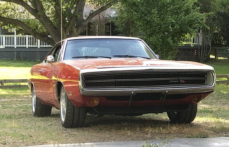

Anyone hate KYB’s. Looking for a shock recommend

...this car is built mostly to go fast in a straight line not corner anyway...
....both descent handling and and a nice/comfortable ride?....
Although you can get close, there simply isn't a 'best of both worlds' shock IMO...you'll need to decide which way you want to tilt the compromise: a little stiffer w/better launch grip; or a little more tire spin on takeoffs but a better ride the rest of the time. A lot has to do with your tires and how much power you're making obviously, but I do agree with your disdain for the KYBs. They're more of a 'worst of both worlds' shock to me..rougher ride without the benefits of aiding drag traction at least in my experiences.
It sounds like you would be happier with a more street-friendly shock like the Bilsteins. I honestly don't think I've ever heard a bad word about them..
(Friggin' love that car BTW!)
