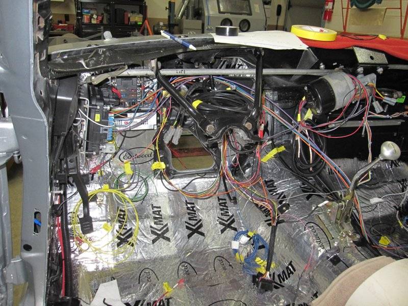

If you have enough years left in you, devote some time to learn about 12 volt wiring and circuits. It is not difficult. Then purchase the wire (many colors). terminals, shrink wrap and loom (different sizes), correct crimping pliers and do it yourself. I'm positive it won't be as involved as my current project.

I've rewired a few cars myself including most recently my '68 Coronet. I've used American Autowire twice now but I can't say I'd recommend using their kits over another brand. While the kits are complete and use decent wire, they base everything off GM wiring and connectors and tailor it to fit other makes. Their replacement bulkhead connector is terrible. It does not fit well because it's made to fit GM products. Plus, they want you to drill holes in your firewall to secure it properly which is asking a lot. Trust me when I say their A body fuse box in particular is a monstrosity and possibly one of the worst aftermarket parts I've ever had to deal with. It was so awkward and cumbersome I cut everything out of it and replaced it with a generic one to 'make things easier.'
They also give you so much extra stuff that you'd likely never use (like power seat and window wires) but you have no choice about it because it comes pre-wired into the harness. If you don't care about extra coiled up wires just hanging out taking up space then whatever but if you're like me, (or you buddy is) you'll end up spending a lot of time and effort re-working your brand-new, $900+ wiring harness to make it fit and function like it's supposed to.
