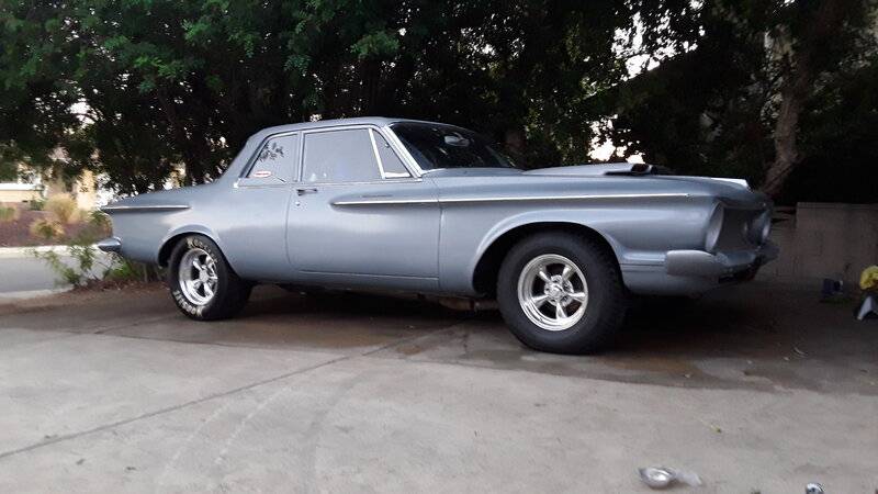

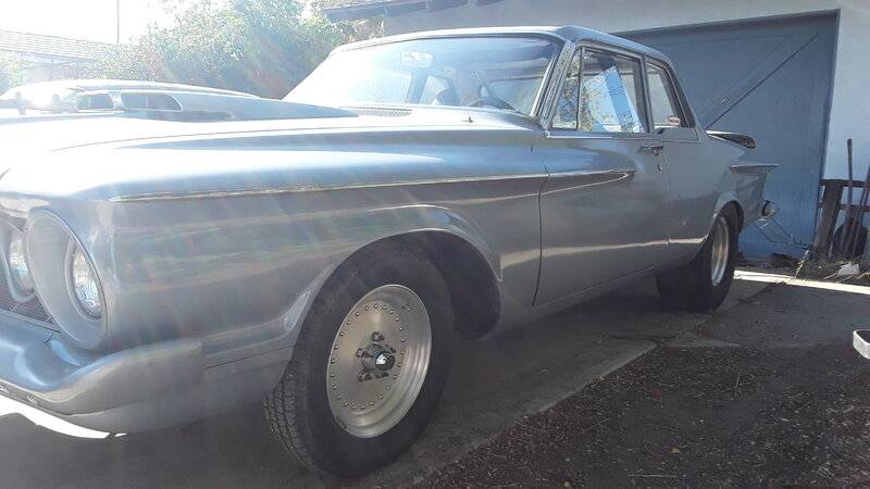

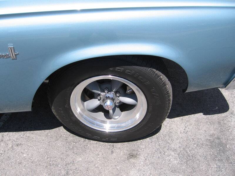

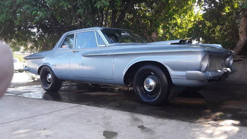

I've got some 235-75x15 but they are on a 62 Savoy . Not much help.
Post them anyway. I want to see how much taller they are than what I have. I have 235 /60/15’s now. I had a calculator on my phone that calculated height. But, I can’t find it now. Thank you
Calculator says 29"tall, 9.25 section, though that would vary, depending on rim width. Two inches taller than whats on the steelies, four inches taller than on the centerlines.

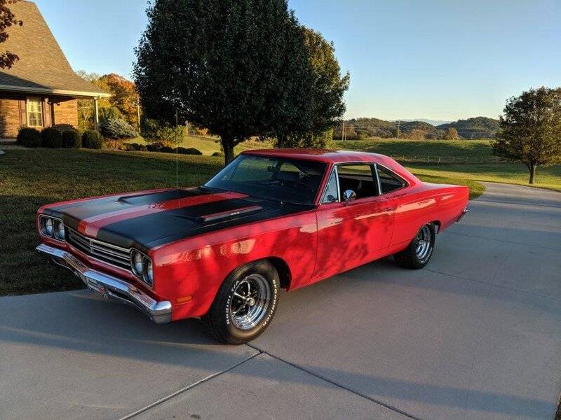

255/70/15 rear and 225/70/15 front
