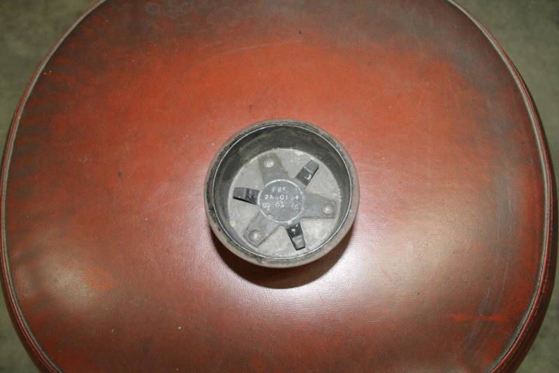

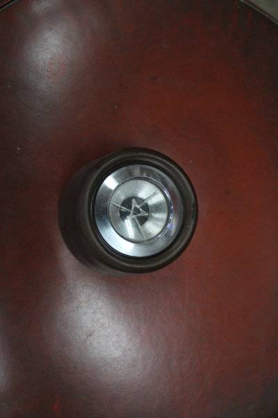

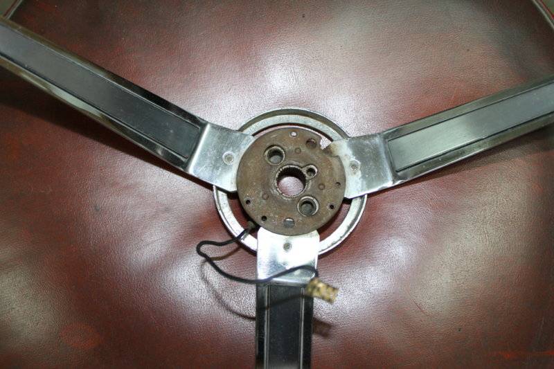

Here's 4 pics. of what I have, Not sure what else I need. Thank you, Terry
66- charger horn brakes mccormic cult.5-21-18 001.JPG 66- charger horn brakes mccormic cult.5-21-18 002.JPG 66- charger horn brakes mccormic cult.5-21-18 003.JPG 66- charger horn brakes mccormic cult.5-21-18 004.JPG
View attachment 608701 View attachment 608702 View attachment 608703 View attachment 608704
Dang Terry, I think I might have one that would work for you......BUT, I'm not sure which one. I went through this myself a few years ago. I found out (the hard way) that there are several different styles of those horn button retainers. It seems like each steering wheel has a slightly different one. If you send me a private message with your phone number (assuming you can get pictures on your phone) I will dig out what I have and send you a picture. I "think" I have two different styles in one of my parts boxes.
Well first of all, what year? 67 had that wheel as an option and the horn switch is different.
The older will not work on 67, I have tried.
67 with out full ring is 2822126
66 3 spoke wheel is 2076543 (I may have one of these if I didn't already give it away)
I attached a diagram pic of what's supposed to be in there. It's generic but insides are accurate.
Mine is a 66. The wheel doesn't have a horn ring, It has a padded horn button. Thanks.
