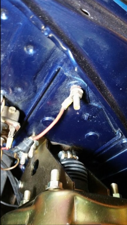

I'm installing the Power Brake conversion from Right Stuff in my 1969 Roadrunner now and I think I may have the booster mounted too low. I used the original holes, but there are holes that would allow mounting the booster about 6 inches higher. I think I might need to use these since the brake lines don't fit right now (Right Stuff stainless lines). Here is a picture of the way it is currently mounted.

Using the factory parts I think you're right, but when I told Right Stuff that the lines didn't fit they thought the booster might be too low. Just want to see someone's install of these parts so I know for sure where they mounted it.
I'll try to take some pics for you tomorrow. I'm having some problems with the car myself. No relation to yours. Pm me with your email address and I'll mail you some pics.
Thanks, any way you could get a picture of your installation? Especially the area where the bracket meets the firewall.
I sent you several pics. Let me know if they're to far away and I'll try and take some better shots of right down on the firewall.
Thanks for all the help. Pictures let me know my booster is mounted right and the lines they sent are wrong.
