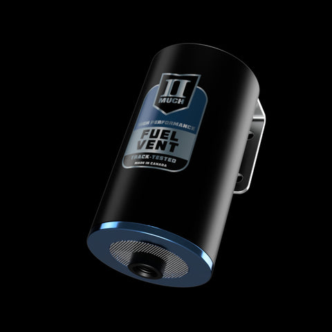

I live in CA and had the same problem with my Satellite when parked in the garage after a drive. Some of it is carb bowl fuel boiling, but some of it was rear wheel well fuel vent related. I installed this II Much Fuel Vapor filter mounted in the trunk and it works great. Much less smell. $200 and change.
II Much Fuel Vents and Automotive Aftermarket products
VSR/E External Remote mount Fuel or Differential Vent System PN 200024E
