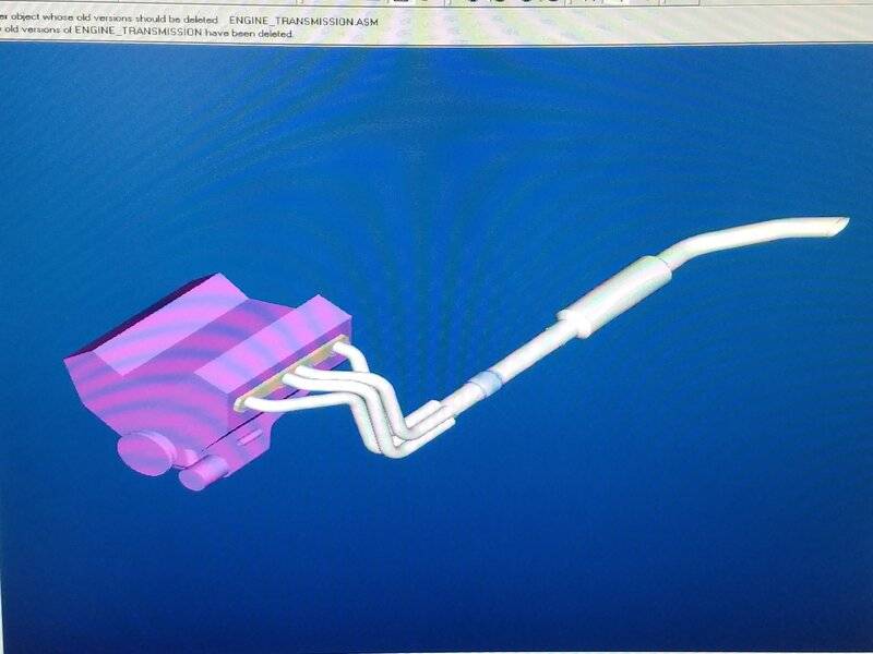

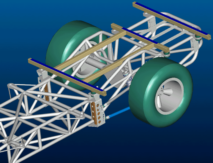

The chassis, upper and lower a-arms, and the
interface of body to frame., and the headers
were modeled on CAD and converted to
working drawings.

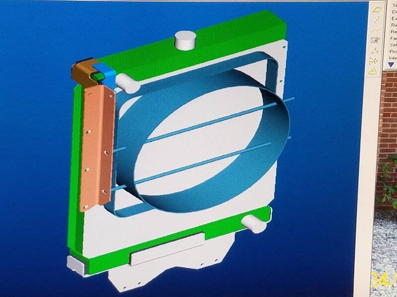

A few of the cad models;
Headers
A-arm w/ weld jig
Frame w/ bed crossmembers
Radiator/fan placement

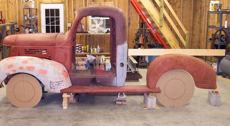

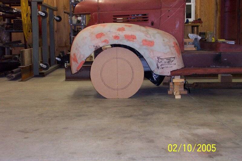

The starting point. I didn't like the long wheel
base so it was shortened 8". Proportions
look much better.
The radiator support was bolted inside the grille
to establish mounting points on the frame. The
cardboard wheels set the ride height and axle
centerlines.

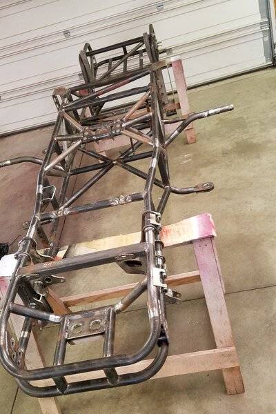

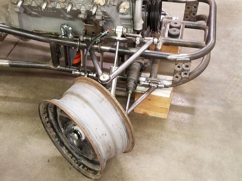

The frame.
Factory 5 concept. 1-1/2" OD chrome moly.
We jigged this up on on a frame table we built
using I-beams. The pics for this process are
on my laptop (it's dead).

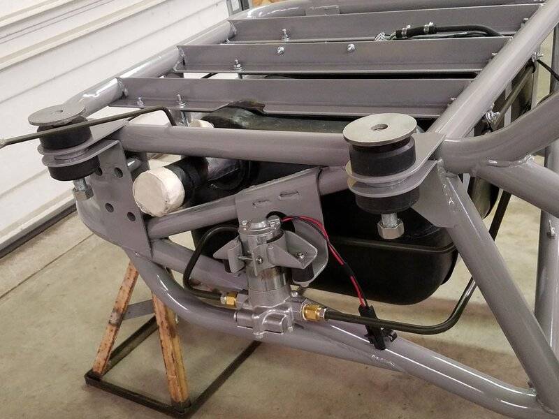

Chassis;
Wheel base - 108"
Koni drag shocks
Mustang II R&P
90 deg miter box steering (from a GM bus).
Front disc-Ford/ Rear disc-Jeep

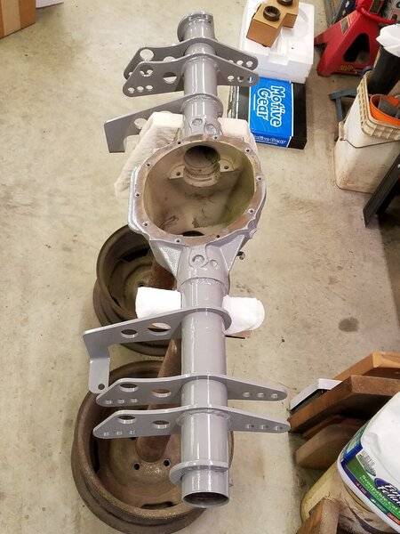

Rear diff- Chrysler 8-1/4* sure-grip with girdle.
3.55 A/R
*8-1/4 rear diff used due to weight savings. With
rear disc brakes, the axle isn't gonna come out
if a c clip fails.

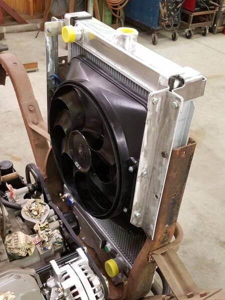

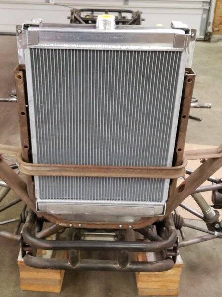

Radiator;
Unknown manufacturer.
Ordered from Speedway Motors.
I needed a 4 core that would fit height
and width requirements.
Mounted in rubber isolator brackets.
Fan;;
Flex-A-Lite 3000 cfm 18x16x4.25
