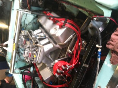

Well it seems that I have run out of carb on my 588 wedge and hemi and need to figure out how to increase CFM to get more out of them otherwise I'm going to have to go in a different direction, carb wise.
Same carbs on 3 different motors and going quite a bit bigger netted the same ET and mph. Almost to the .00
So I need to improve the flow of the Edelbrock carbs.
Any information and tricks are greatly appreciated.

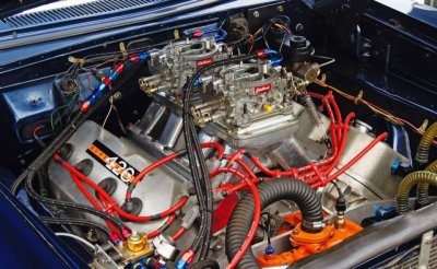

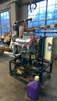

here's my setup now
