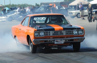

I watched this Hemi Road Runner run 8.60's in September in Norwalk. 2 Eddys on a 605" Hemi. Car is a legal NHRA S/S, not the motor
Doug
Doug
I wonder who's carbs he was running and what mods were made to them because if they were stock out of box Eddy's I have one hell of a turd for a engine.
Even Bob@MCH said my carbs are like corks for this new combo. Next place to look is the stock intake manifold. Bob wants his hands on it ASAP.
When I walked up the intake was covered with a towel. I had just seen the car go 8.6X. You can imagine my surprise when he lifted the towel and I saw they weren't some type of Holleys. He said they were out of the box. Hell they still had the chokes in them.
Doug
Doug
The car had to be a potato chip, no way you going 8.60's with stock Edelbrocks. I have talked to every carb guy in the last week regarding CFM and they all say you are limited with these carbs in terms of ET & MPH.

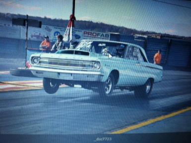

Maybe you could use what this guy is using!
http://www.youtube.com/watch?v=41sHfcRf1FA
Is this a trick question? :confused2: :confused5: :icon_rolleyes:

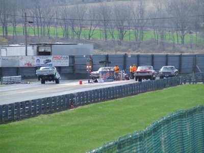

^^Not a trick question, just a trick car! (From 2011) Thought you would enjoy :)
Do you realize that my car? :icon_weed: I wonder who's driving it? :headbang:
It's hard to tell who's driving it but it's your car! Lol. Those 90/10's are getting a workout...
I don't think so. Still has the stock steel hood, bumpers, hood hinges, Roll up glass, stock style front suspension, ETC. If It's light it's really well hidden. Fooled me.
