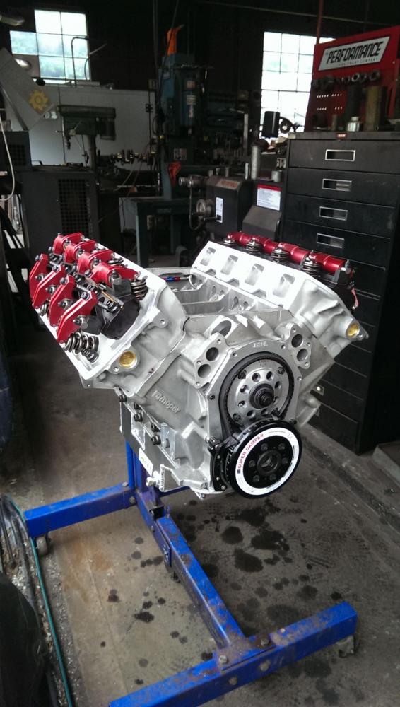

here's the setup,

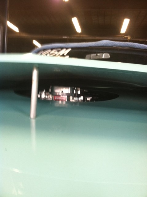

Just a thought SSR......If your hood scoop was sealed up to the carbs via a sheet metal and foam pan , you would get some ram effect....

have you made a pass without the hood scoop,the carbs look very close to the scoop ??

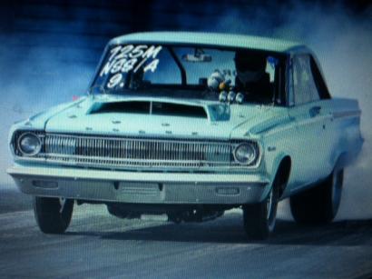

YES, with same hood scoop different motors. Been running it like this for years. My other scoop was even closer with no issues.

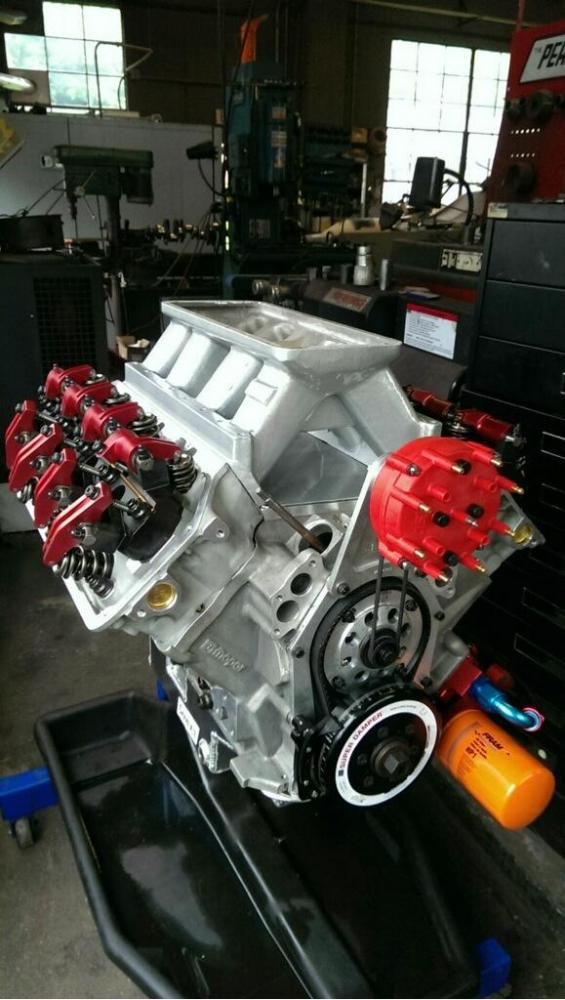

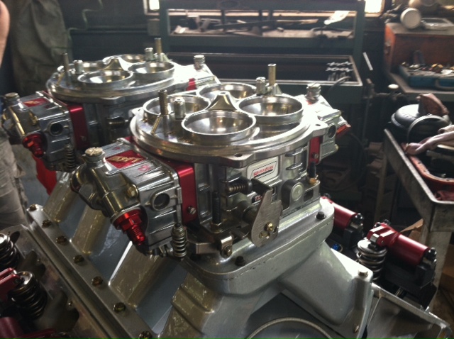

Trash them! get 2 950 Holleys or a pair of Dominators and be done with it.
you mean like these!!
I'm trying to avoid using these and get my 8 second passes in the summer months with no issues.
