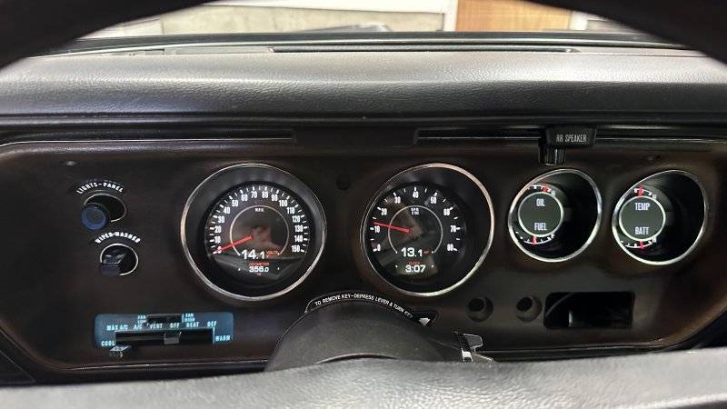

I guess instead of a separate new thread I’ll add my issues to the mix. I put in the Dakota digital dash in the 70rr and got it all hooked up a calibration done. At first I was getting the volt meter at idle to read between 17-18v…too damn high,would be comfortable at 13.8-14.2v. Now this is at idle with a standard old school alt.
A buddy suggested change the VR and that didn’t change a thing. Is there a certain VR that will work for the digital dash I have or is the dash the issue?
Could just be a bad (new) VR.

I would verify there is no alternator output with the vr disconnected and the voltage drop between the battery and the ignition 1 circuit at the regulator is within specs before dropping more money on another vr. I'm running a DD in one of my cars, no issues.

Did you measure voltage across the battery terminals with the engine running? If you are only getting 13.5 - 15 volts across the battery you shouldn’t see 17-18 volts at your instrument panel (I said “shouldn't see” and not “can’t see” as wiring can be monkeyed with).
What i was hoping to see at the battery terminals was 13-14v,but what i got matched the gauge in the digital dash 17-18v. So at least that tells me that the gauge works. It is after all plug n play.
I’m going to go through the calibration instructions again and see if I missed something.
Otherwise a better VR is in my future. When I took it out for an extended drive to set the speedo I was getting a high reading on the volt meter fluctuating up and down at different speeds. When I came to idle at stops it would show 13.8v which I considered safe.
Heading down the road it climbed back up. Hope it’s as simple as another VR. I’ll keep you posted. Thanks listening!
17-18 volts sounds like the alternator is in a full field state. Disconnect the VR and verify there is no alternator output while disconnected, that the regulator has control of the field current. Shorted field brush or field lead will cause the alt to full field.
I tried another VR with the same results. Buddy of mine said stop messing around with the cheap Chinese crap and order up a Mopar (USA) one and that should do it.
The boys at my local Napa said it sounds like the alternator could be the problem. How can the alternator push those big volts through the VR if the VR is doing its job?
Maybe it is an alternator problem! I’m totally lost on automotive electronics!

Do you have a round back, single field alternator? I don’t think the connections could be mixed up on the alternator without deliberate effort. As I understand it in layman terms ( I’m not great on electrical either). The VR evaluates the car system voltage levels through the ignition circuit and through the field wire provides a signal back to the alternator to adjust the alternator output accordingly. So most likely it is the VR, or the field circuit is somehow being shorted or crossed with another wire, or maybe the field coil inside the alternator has some fault.
