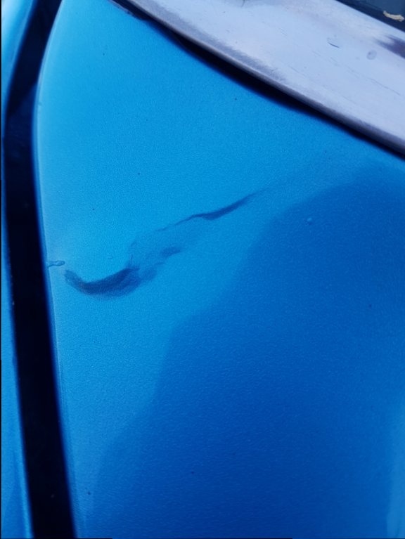

Anyone know what has happened here?

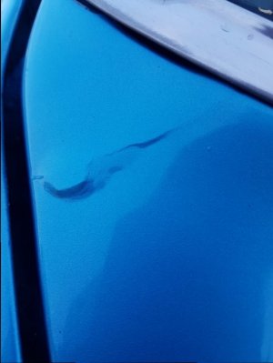

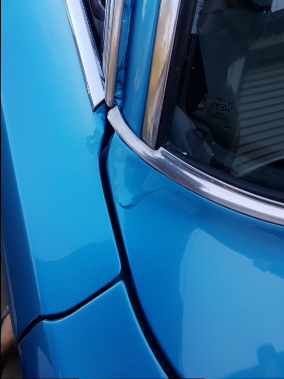

These are almost like creases. Its not bog. Would this be caused from a front impact?

Looks like a bad repair, badly hidden, beneath bad paint.....from this angle.
Ya know my 69 had lead in that spot from the factory and my son n laws charger may have lead there as well. I know that it knocked out when I began disasembly, not saying Im correct but that's what i'm thinking is lead at the bottom of post
Not bog?
Was that "autoccorrect" for Bondo?
That is a place where the factory did use lead. If corrosion gets behind it, it can and will separate from the steel. You might have to dig/melt it out, eliminate any corrosion and refill with either more lead or a safe filler.

Whats the best way of attacking it?
I have said this before about rust.....it's like an iceberg, only about 10% is visible or shows. The remaining 90% needs to be exposed and dealt with. To me, that car would not pass an New Zealand OR Australian road safety/worthiness check.
Best to find a good panelbeater that you trust (if you cannot do it yourself) and get that dealt to, before it becomes more of a nightmare than it could be already.
I definitely would not be 'mashing the go pedal' before getting that sorted out. :steering:
