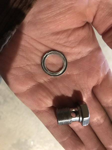

A 16mm very thin crush washer made of stainless steal. It’s for the banjo fuel rail for on an edlebrock carb. Looked everywhere, I need 2 of them. No parts stores carries them. Can’t find em on Ebay either.

They are definitely stainless. They are included with Edlebrock fuel rail. They are very thin. A kind gentleman on A body site helped me locate some. Thank you, for the responses.

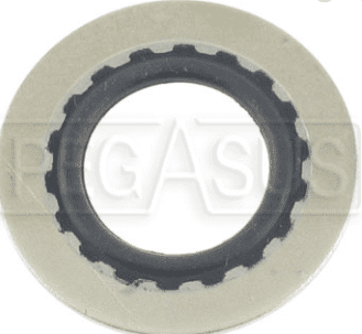

To be honest I too find it odd that a crush washer is made of stainless since stainless is really hard to crush.. Typically I see copper & aluminum crush washers, nylon crush washers suck, they don't seal well... I actually have an assortment of crush washers at my shop, but they are an aluminum outer with a buna N inner seal..
It’s not genuinely a crush washer, I agree. This is what Edlebrock, Spectra and probably Holley too. Include with those fuel rails you buy separately with a 90 degree elbow and have a port that has a pressure gauge attached.
