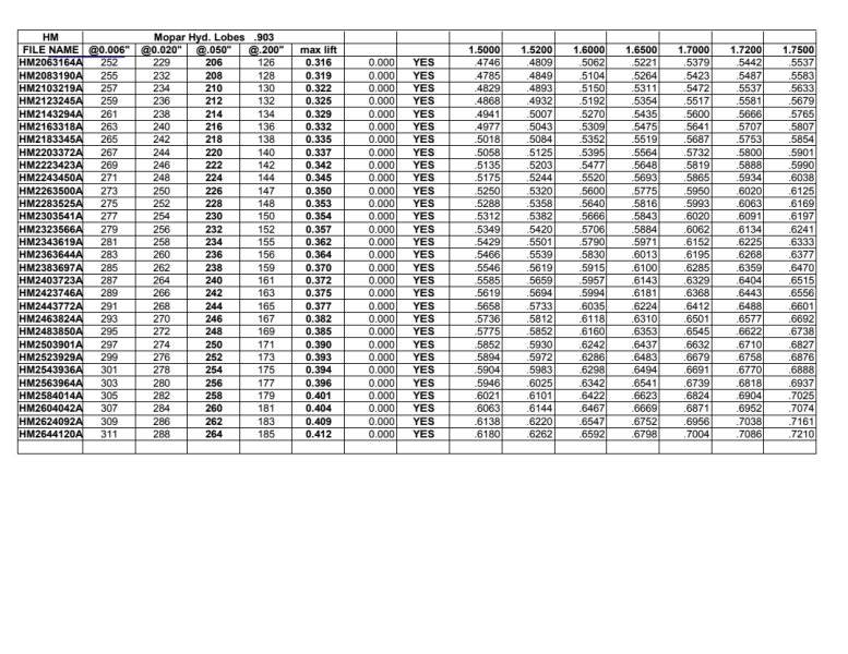

What is interesting is the FT cams, above: for the same 050 duration, the FT cams have more lift than the rollers & generally only 1 or 2* @ 200 lift.
I noticed the same thing years ago when perusing my Ultradyne catalog (pre Bullet days). So I called old buddy Tim at Ultradyne, and he explained the initial movement vs ramp velocity/intensity "thing".
A "true" .904 SFT can move off of the base circle quicker than a even a solid roller can, but the flat tappet ultimate lift rate is around .007-.0075 thou per degree. A solid roller however, can achieve a lift rate of +.009 per degree.
Howards SFT ramps are more aggressive than Ultradyne's in that they stay at max velocity a few degrees longer than Bullet/Ultradyne. This does require more spring pressure though, so the question of the oil/sliding Interface issue is more critical.
Howards, Ultradyne/Bullet, Mopar SFT's are generally more effective (have better profiles) than a lot of Hydraulic Rollers do. And, given the somewhat poor state of hydraulics these days, can be a better choice IF YOU ARE WILLING TO ACCEPT a bit more maintenance.
Tim mentioned (back then), that it wasn't uncommon for SBC circle track guys to open up their lifter bores to accept Mopar .904's, and run an EDM with a Mopar profile (particularly if they'd had a roller failure wipe out a motor).
The larger lifter diam was the basis for using mushroom lifters, to get more lift & 'area' under the curve.
How has Howard's managed to get 0.020" or more lobe lift for the same 050 number than other companies??? That is a huge amount. They all use computers these days to generate their lobe series.
It seems that Howard's lobes stay at max velocity just a couple degrees longer, which tranlates to the additional lift. This is where the extra spring pressure is needed, as given more lift over same duration requires "deceleration/closing ramp" to happen quicker (more abruptly) than a lobe with less lift for a given duration.
And yes/agree, cam manufacturers have used computer programs for years (all the way back to the '70's).
