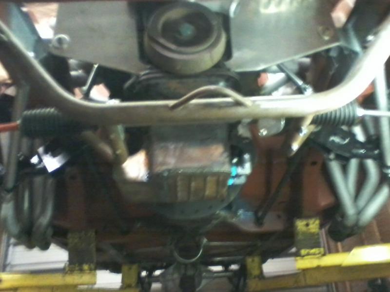

QA1 is ALSO Tubular and you can use your stock T' Bars ! Alot better than trying to support the weight of the front end at the shock mount ! Look into them as thay are Very nice parts. I use there upper and lower control arms but bult my own K unit. OP1.jpg
