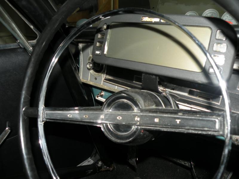

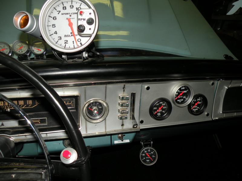

SSR are you going to install the screne/display/gauge panel, like the other car ??...
Bud, already installed and it looks badass. ill get you a few pics tonight.

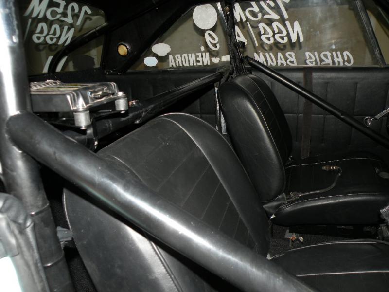

Got my package last night and its almost finished. i need to run O2 sensor preheat wires to 16volt ignition power and ground them.
Im running dual O2's again. I am so close now.:banana:

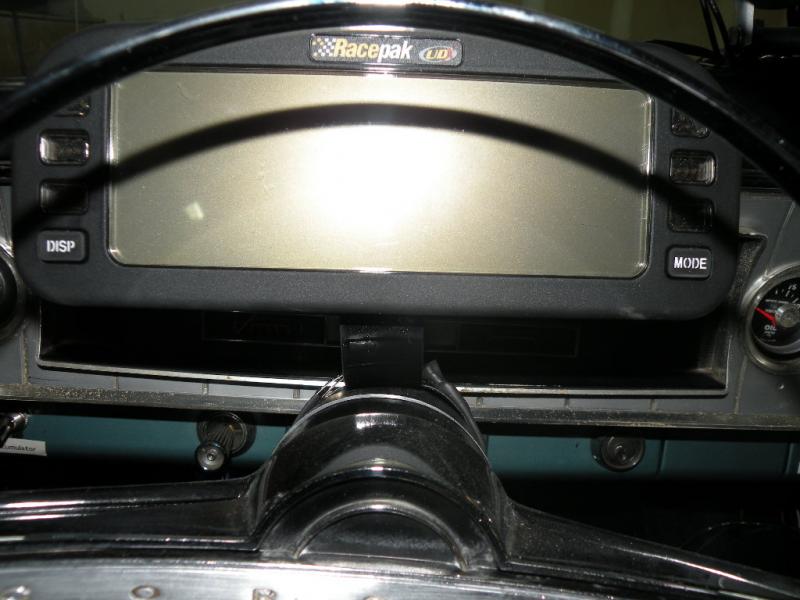

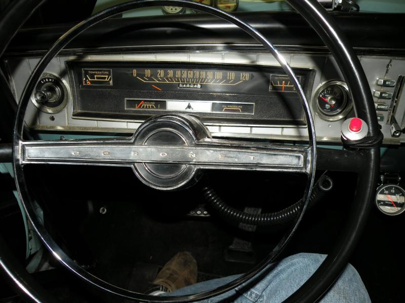

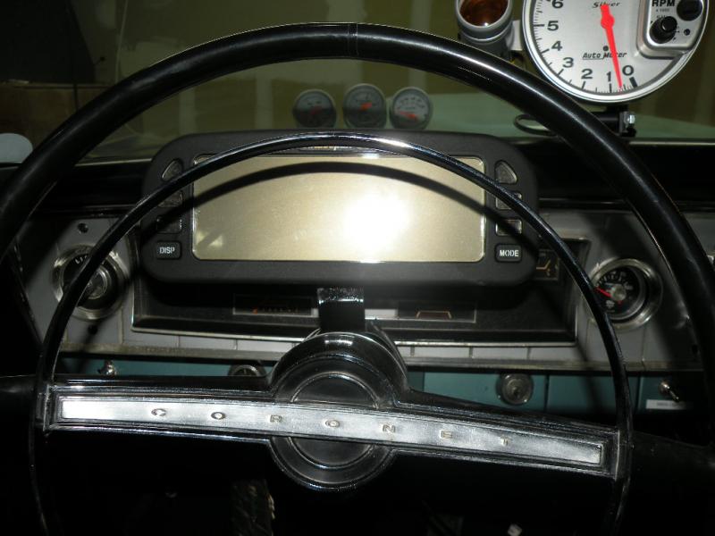

This is for you Bud.

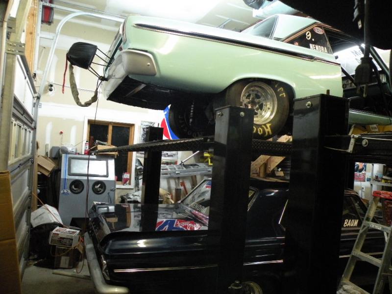

Think it looks pretty darn good. Almost there now. You'll see why i cant get to the O2's under the car by the pictures. Car is on top lift.

SSR That does look great... Thanks for the car ****, hope you get to test soon, we just had a bad snow storm go thru here on tues & wed., it's heading east now, hopefully it doesn't effect you guys up north, in your neck of the country, you've had enough crap weather already this year...

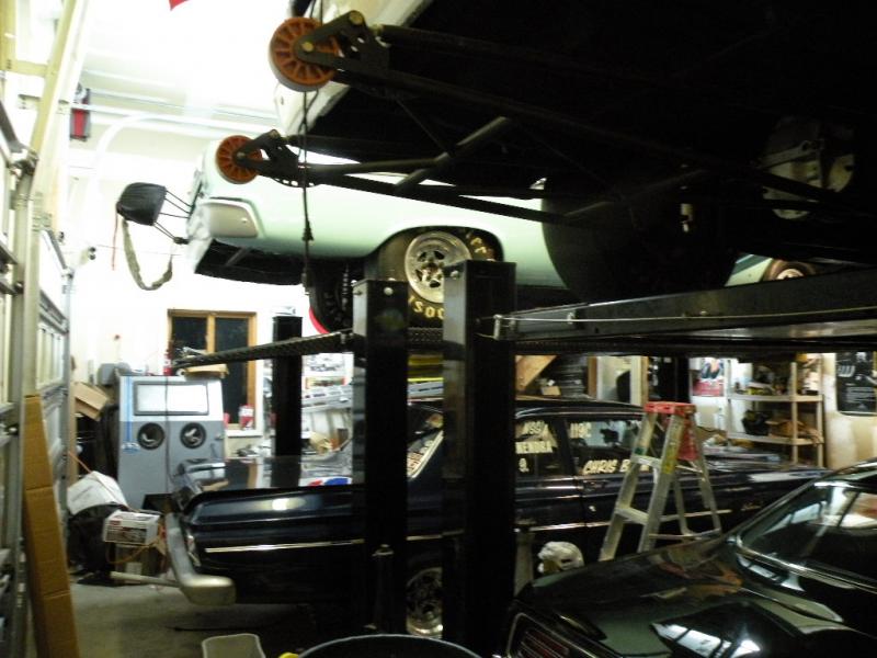

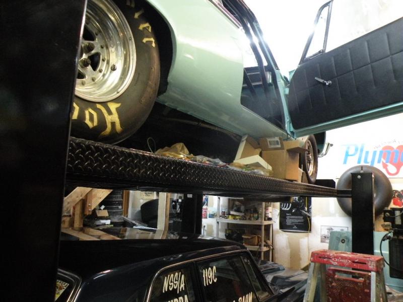

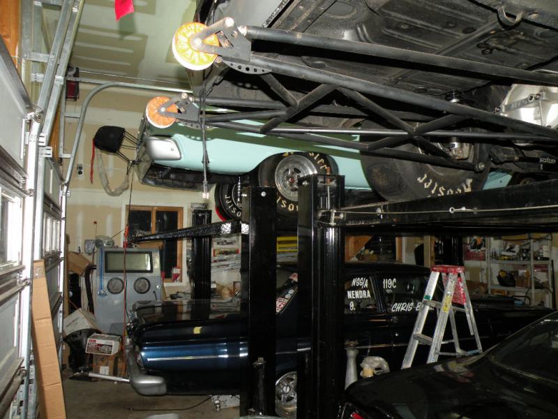

heres my holdup,

nice garage full, double stacked even...LOL..

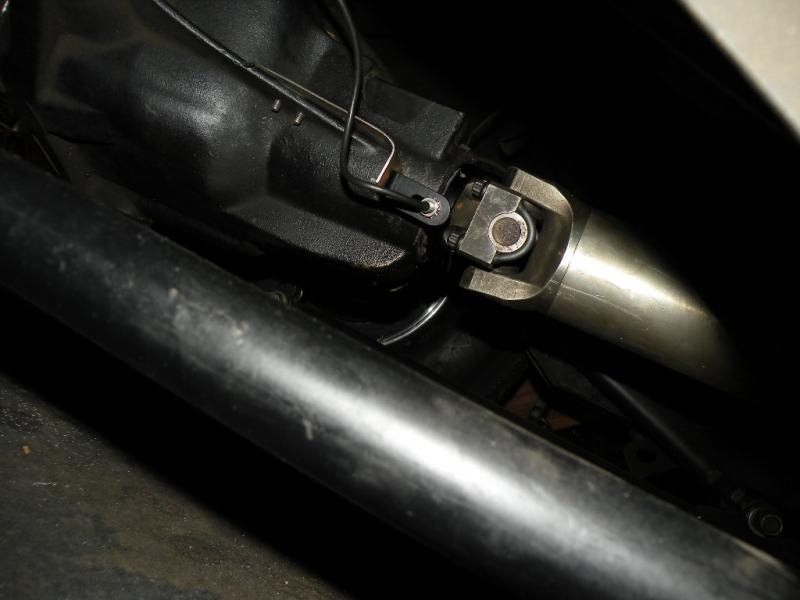

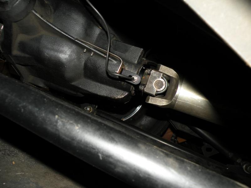

LOOKS like i need a Mark Williams pinion yoke. my Racepak driveshaft sensor magnet doesnt fit with a moser pinion yoke.

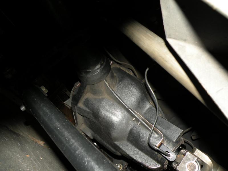

It was an all day affair to get everything wired up so sensors work and got the fuel pressure sensor all plumbed in. Ran all the other sensors out to through the firewall. put back the rug and got sill plate put back ,Driveshaft sensor wire all tied up neatly too.
what's the difference between the MW & Moser yokes ?? & why it won't work with the Moser yoke ?? I'm just curious
Theres no clearance for the driveshaft collar.
Collar for MW is 2_7/8
Diameter. My racepak collar is too thick and I cant get it in between
The yoke and pinion case. Looking at my Hemi with the MW yoke plenty of room for the collar.

Just drilled out my dana for the new sensor bracket which looks great.
area.
MW yoke has a thicker flange which keeps it away from the dana pinion case. this is where the driveshaft collar goes on.The moser one goes in flush with no area to put the collar on.

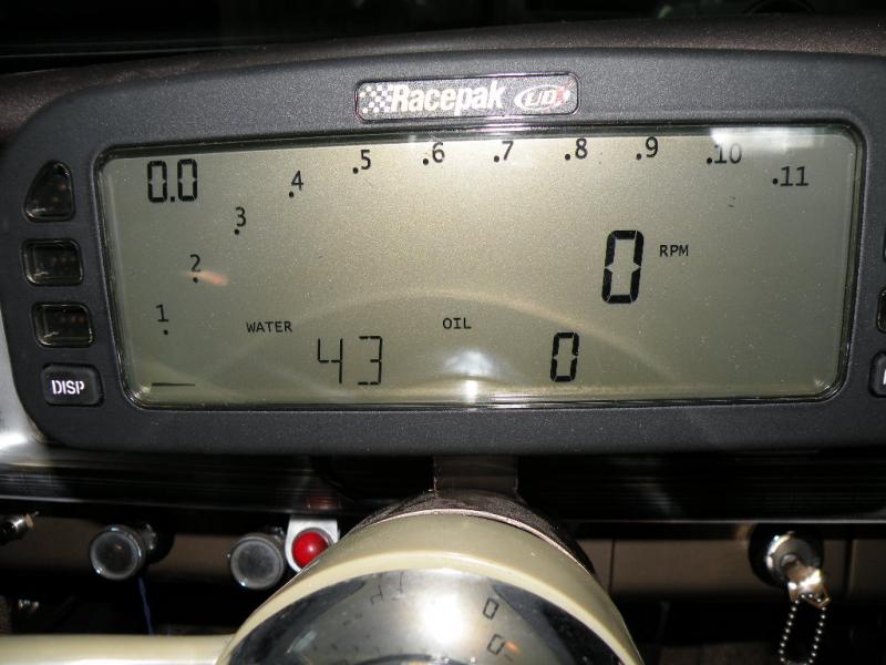

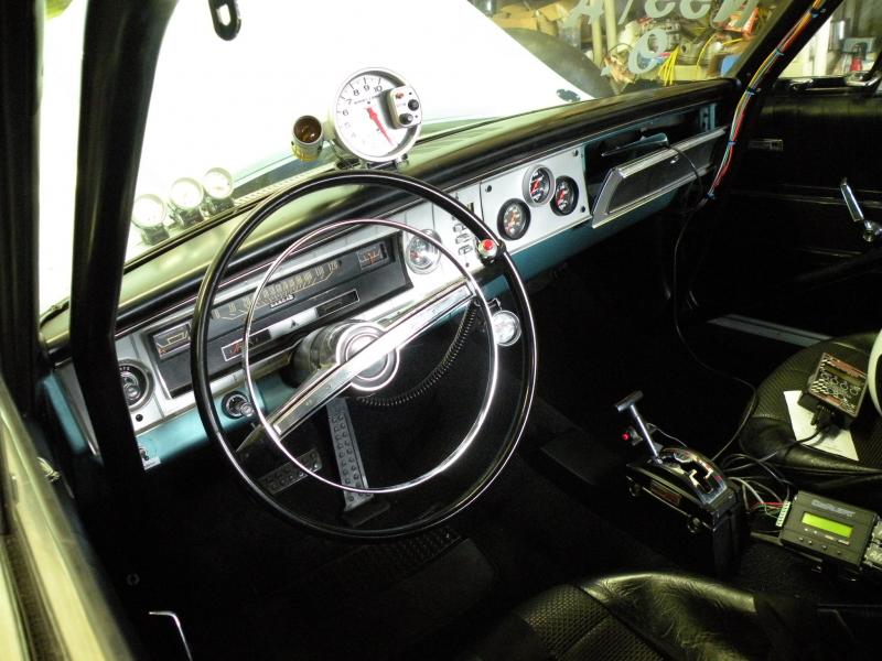

just programmed the UDX DASH with my laptop computer and now all my sensors are visible on the dash
got the fuel pressure,water temp, oil pressure and volts on 1st screen
on 2nd screen we see both O2's and pan vacuum. i might be able to put 1 more sensor on 2nd page.
Cant wait to try it out.
Also got the racepak to start recording right in the burnout box automatically and start recording at 6200 rpm.
