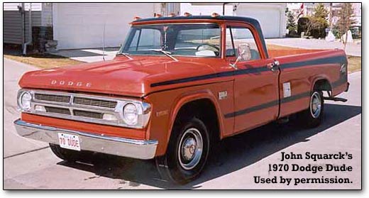

Did you happen to get that truck from the Dallas/Ft. Worth area?
Nice Dude, great score
don't think I've ever seen that color green "dude" in person
seen a few orange, yellow & light or dark blue thou
none mine unfortunately

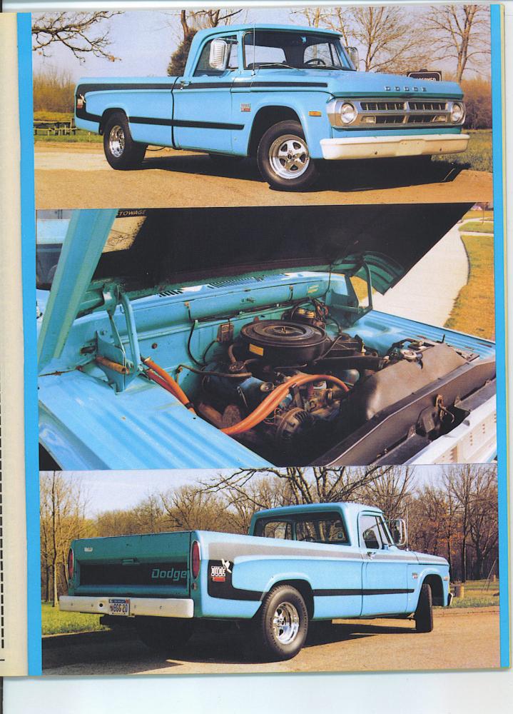

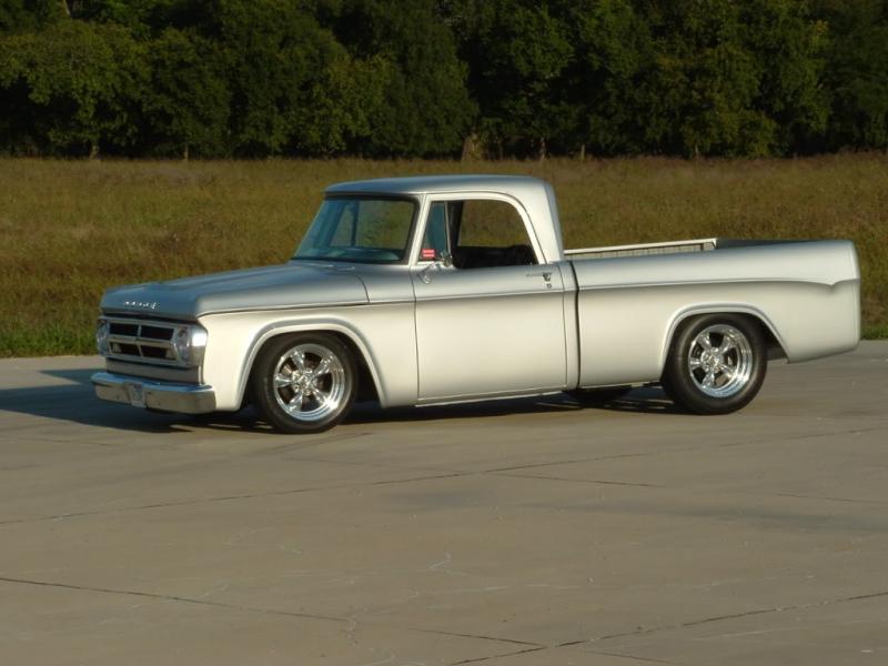

here's another one I liked
:headbang: not mine, but very nice ride

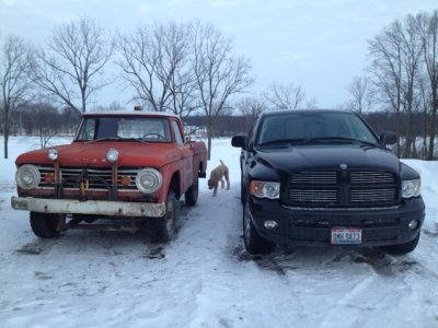

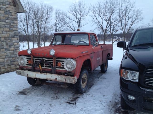

Some pictures

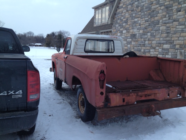

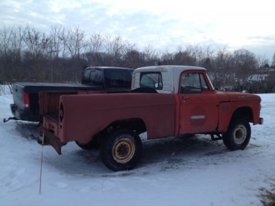

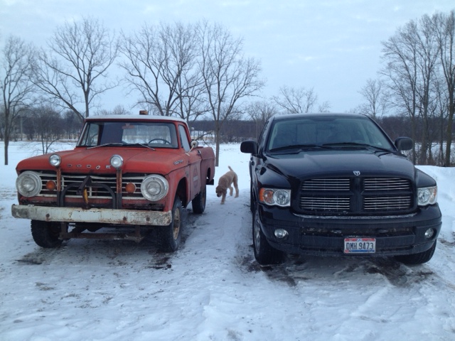

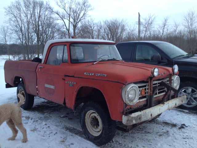

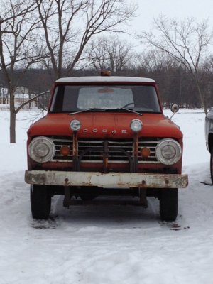

I finally got it home last Saturday....it's not much of a looker but has potential. Although the truck only had 18,800 miles....it was a plow truck and spent it's entire life outside...in NW Ohio (rustbelt) so the body is shot. All the sheet metal on it will be replaced.....I'm in search of a bed now. Fortunately it came with a relatively rust free cab (floorboards need a few patches, but outer body is in excellent condition) and front clip (less hood) so I'm half way to having it fixed. I'll plan on doing the preliminary bodywork on all the pieces before doing the changeout so I can drive and enjoy the truck while that is in process.
I managed to lose the only key within two hours of getting it home....it's somewhere in the snow and will show up when it melts (which may be July the way it's going around here).
The dog has already called shotgun and won't let me drive it without him. It's right at home with it's 38 year younger sibling parked right beside it.
