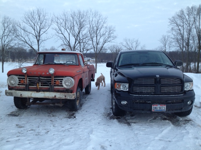

As ugly and rudimentary as the plow hook up looks....it was a factory installed option. The data tag has it stamped as optional equipment. For my intents and purposes, the plow attachment will be coming off....the truck has already served it's duty and now it's off to a comfy retirement.
The search for a bed has turned up empty so far....seems the only ones offered are out west. There is one guy in Michigan that may have a lead on one, but won't know until his friend gets back from Florida in the spring. I'll keep pinging the truck sites...but traffic on those is light in comparison to this site. Craigslist and e-bay are pretty light on sweptline stuff too....anything that shows up worth pursuing is far west of the mississippi....looks like a road trip may be in my future if I can't dig anything up here.
My wife says it's ugly....but something in the way she looks at it makes me think she actually thinks it kind of cool. She likes "out of the ordinary", so I'll bet she will end up driving it once in a while. She will definitely hang the purchase price over my head to get leverage for something she wants down the road.
I finally got it home last Saturday....
The dog has already called shotgun and won't let me drive it without him. It's right at home with it's 38 year younger sibling parked right beside it.
very cool,
Enjoy both you & the dog

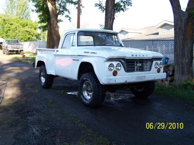

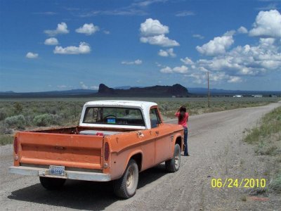

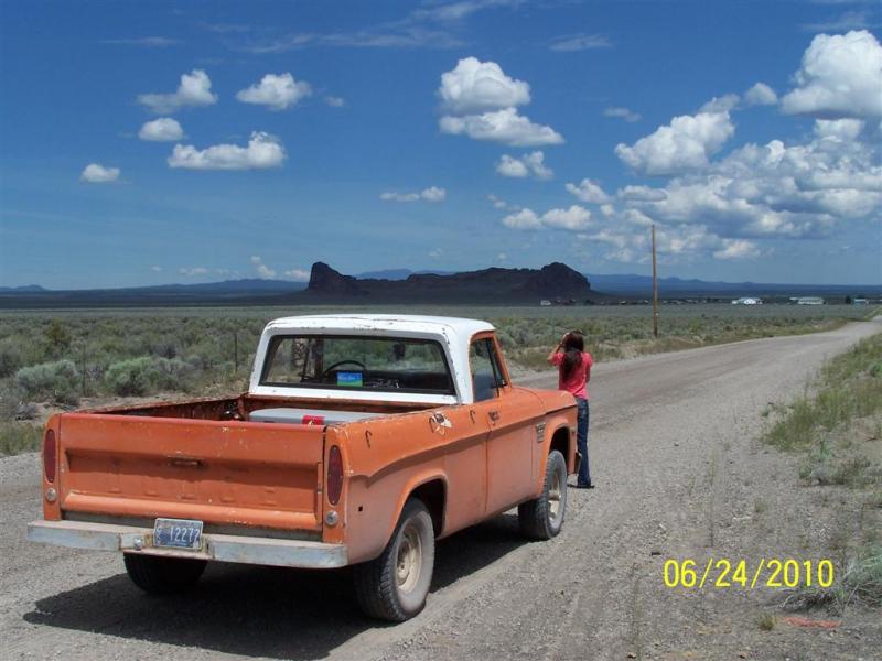

I'd be interested in the plow setup. Let me know if you are looking for parts we have a few of those trucks hanging around.
