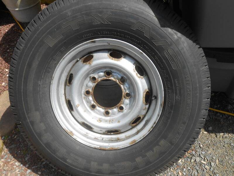

Anyone recognize this 8 lug 16 inch spare??

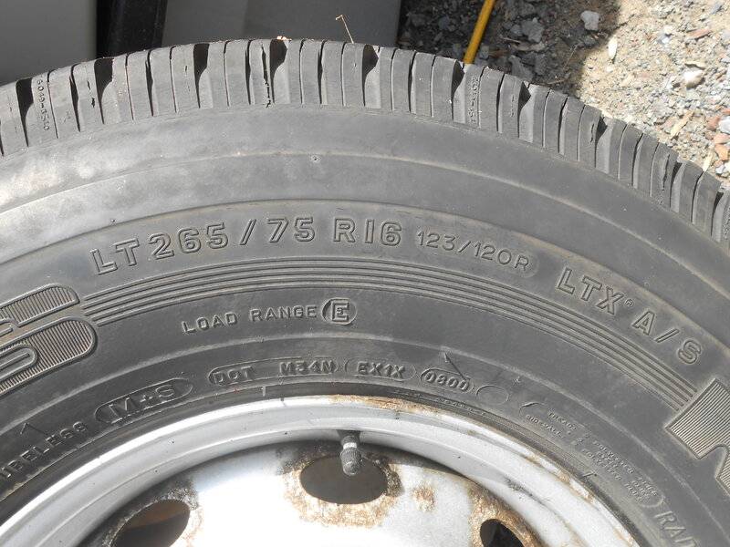

Had this show-up on one up my jobs the tire is like new. Don't know if it was dumped there or fell out from under the truck... It is an 8 lug rim with a like new Michelin LTX A/S 265/65R16 Thanks in advance..

Put my glasses on and found some info on outside of rim... Made in Brazil Fumagalli rim Could it be for a Dodge?? Tough to read part # 5GE66 TRMAA
Looks like the spare that's under my 2001 Ram 2500 - both the rim and the tire. They're known for letting loose if the cable holding them rusts away.

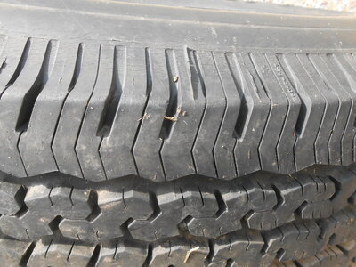

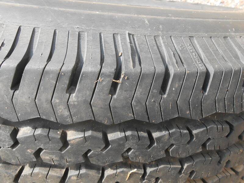

Yep, the DOT code shows it is a 20 year old tire. Probably not safe for any use now except for moving something around the Farm or yard.
mystery solved! Was going to say looked like a dodge wheel. ruffcut
