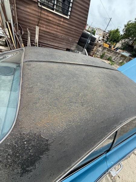

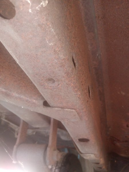

Found a 70 Satellite 318 Auto with 55k original miles that looks really impressive, but there are some issues with the body and I was wondering if I could get advice on whether or not it is worth work needed to fix it up.

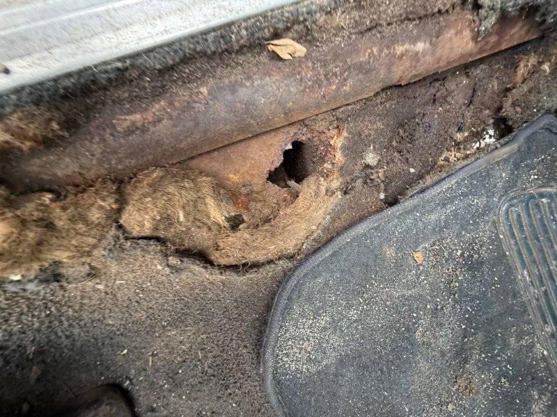

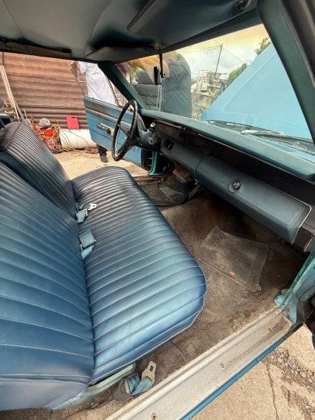

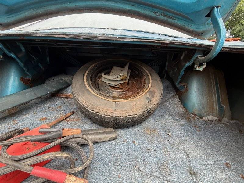

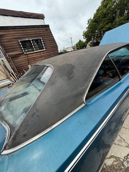

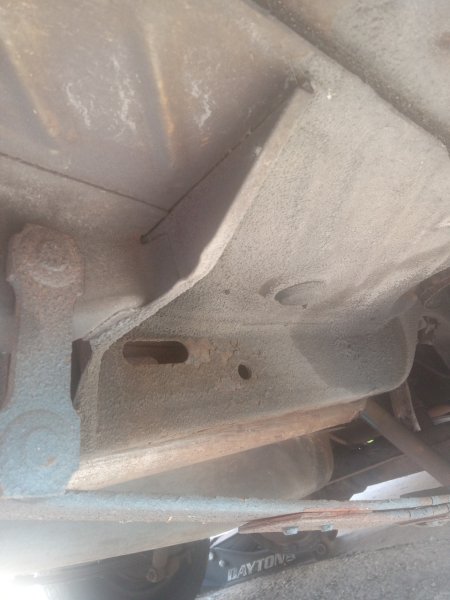

Right off the bat you can see that the roof it shot will most likely need a new skin. This has lead to rust in and around the rear windows and dutchman panel which has destroyed the truck, the pan is shot in the middle, you can see the spare tire was eaten alive practically. The positives to this are that it has a great undercarriage, the car has been kept well, the interior is about as good as it can get , but there is a hole in the drivers floor.

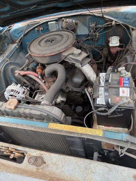

The car starts right up, drives well, Gas tank looks to be in great shape but you can see in the fuel filter there is crud in there. The motor shows a lot of caked up oil in the picture, not sure how bad that is ?
I need to make a decision ASAP , if anyone could help with some advice I would greatly appreciate it. I am wondering if anyone has an idea of the costs associate with the extent of the work needed , I fear that the roof alone would cost like 10K+ but I have no idea when it comes to body work.
55K miles is meaningless on this car.
Can you do the metal repairs? Or are you paying to get it done?
Strip the interior out so it doesn't get destroyed replacing the roof.
remove front and back glass.

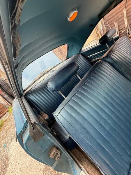

Seats and headrests are recovered in a generic pattern, not original anymore.
Outside has been repainted. Rust on top of rear arm rest ash tray.
This car looks good but it's a total restoration if you want a nice car.
Then when done you still have a 318 satellite.
Move on if you can't do this yourself, buy a solid car, more money up front, less headaches.

Floor pan patches, new trunk floor, rear window channel and who knows how much roof issues under the vinyl... costs will vary depending on if it is Bubba down the street or a restoration shop.... but yes assume $10k-15k just to do the metal. Then you need a paint job, where again cost cary widely.... but is generally the most expensive part of a restoration.

It really doesn't look that bad to me. The OP seems pretty inexperienced so a lot of the comments he makes about the rust might be incorrect. Yes it's had a trunk leak but that's common. The spare had some water on it - so what? Doesn't look "eaten alive" to me. Frame rails look great, floor might only need a patch - not everyone does a concourse restoration.
The roof looks like it might be ok, but you won't know unless you're looking at it in person or can pull some vinyl off and have a look underneath. "Caked up oil" on the engine? It looks pretty clean to me, and if it starts and runs well that's a good sign.

Roof has had the vinyl top replaced once before.
I wonder how bad the rust was the first time.
You really need to remove the vinyl to truly asses the actual damage.
If it's "just" one or both corners...patches are made.
...but it could be the whole skin and drip rails.
Trunk floors are also super common rust areas in 68-70B cars.
Patches are made.
Look real close under the car, and the frame sections...directly underneath the rust hole near the driver's side floor mat.
That could be a whole 'nuther can o' worms.

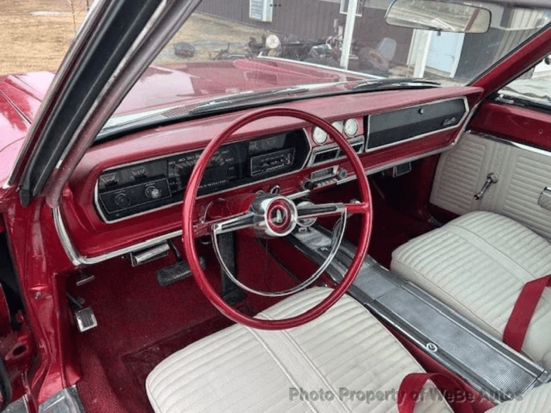

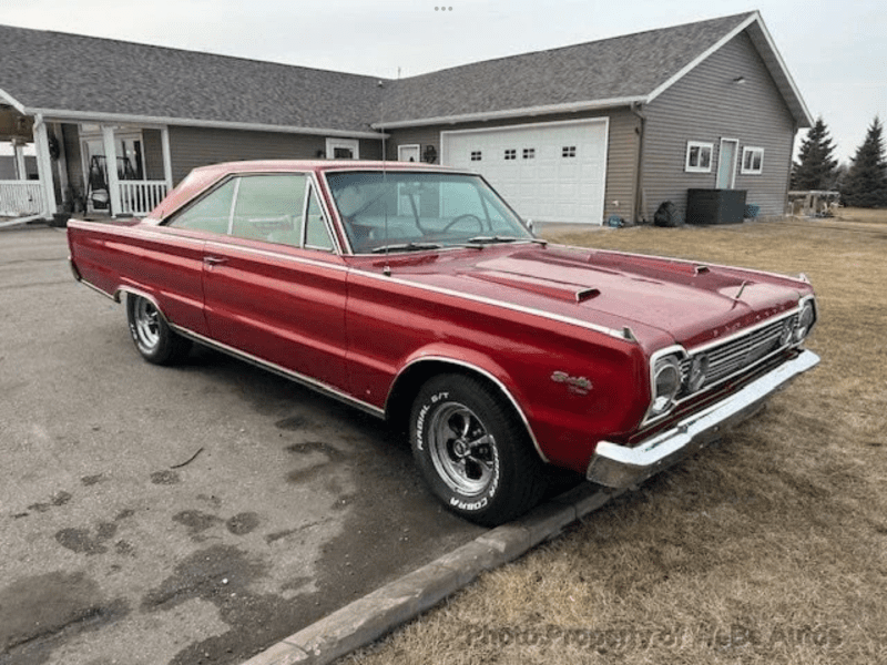

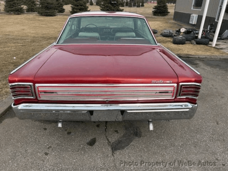

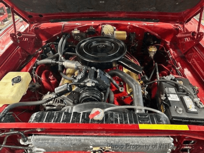

Not sure if he is stuck on a 1970, but for less money he would put into that car, he could have a 318 car like this.
$23,995
Vehicle Specifications​
1966 Plymouth Satellite​
  • VIN
    MEL6602
  • Classic Car ID
    102228674
  • Stock Number
    MEL6602
  • Category
    American Classics
  • Body Style
    N/A
  • New/Used
    Used
  • Mileage
    15 miles
  • Engine
    Other
  • Transmission
    3-Speed Automatic
  • Exterior Color
    Red
  • Interior Color
    White
  • Factory Air
$23,995
https://classics.autotrader.com/classic-cars/1966/plymouth/satellite/102228674

Any rust holes in the painted body besides rear window channel?
If not, IMO it's a good candidate for "cut/buff and drive as is". You don't have to be a body guy to repair trunk/floor pan rust.

And the caked oil on the engine acts as a preservative (actually looks like a valve cover leak), it's a good thing.
