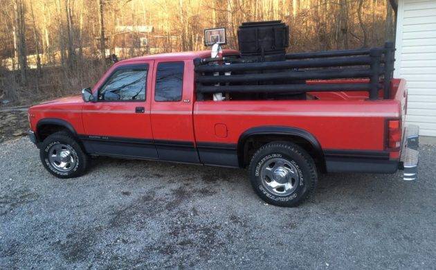

I'm thinking about running on wood gas.
Wood Burner: 1995 Dodge Dakota 4×4
