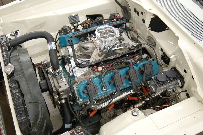

I put dual quad snipers on my 528” Hemi this spring. It always starts and I don’t smell like exhaust after a drive. I’d never go back to a carb and points. This is the 4th car I’ve converted to EFI. 2 LS swaps, one Hamilton EFI setup and then the sniper setup.

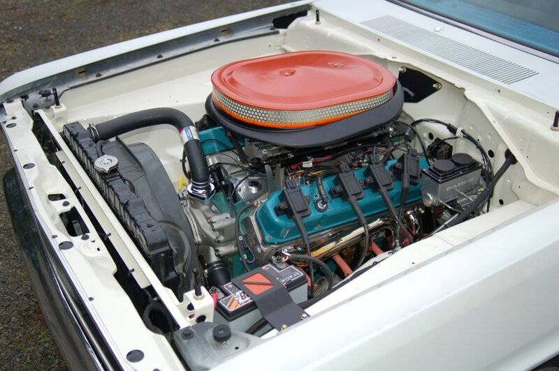

What, no pics?

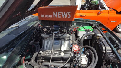

Just my ho-hum 383. Ran 2 different sets of carbs prior. Love the sound the tbs make when I get into it.
Going timing control, just need to install.
