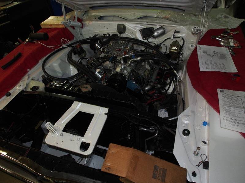

I have them, but my car's been off to the paint shop for months and I honestly don't remember how the wires run. But, here's bump for you. This is the only photo of that part of the car I can find and it's too dark to see details. Sorry.
