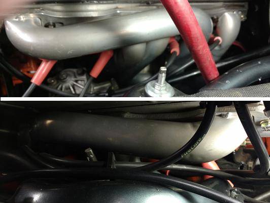

I’m running straight connectors, except for #2 on my 65 with TTI headers and Edelbrock heads. #2 has a 90 degree end. Pictures don’t really show much, sorry.
F98F2BCC-3FB6-4851-B87F-A264E8C5D290.jpeg AC2B4D81-6F46-44BD-94E0-105DAF4B2976.jpeg
Firecore. All are angled the same but I'm not sure if they are 45, 115 or 135.
The passenger side picture is worthless.

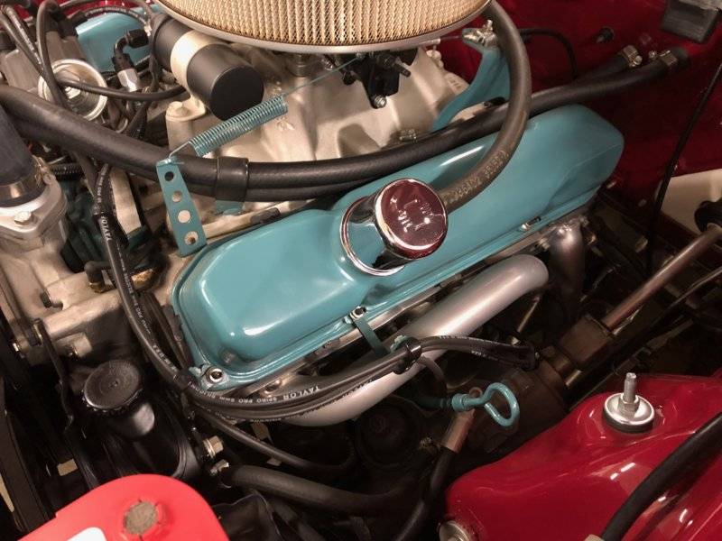

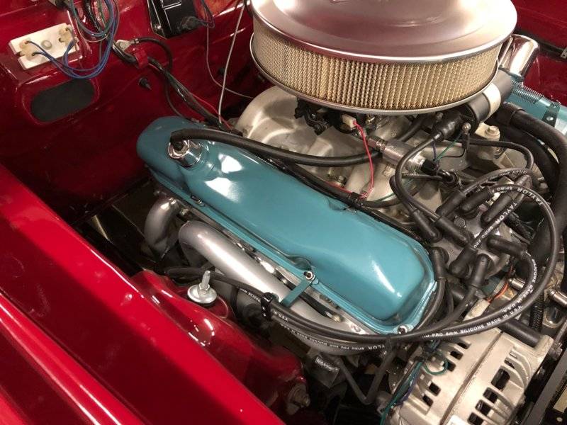

You'll need both 90 and straight ends!
#2 is straight #4 90 degree # 6 straight #8 straight
Steve, I'm not sure why but all my ends are the same angle. They all clear the headers and none are burnt after four seasons. I ordered them directly from Rick and that's what I received.
