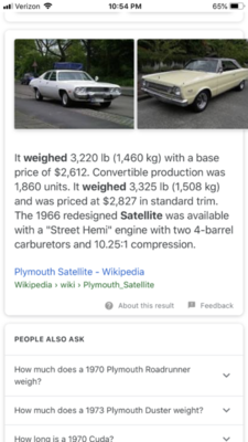

Your right I am wrong. My car is actually lighter than I stated...
Your article is in reference to the 65 model year. Just read the same article
You looked at Wikepedia for facts? Come on, man...They "Fact Check" as well as CNN before airing their stories! (FAKE news!)
Try ALLPAR or something directly car related. Better yet, take your car to a certified public scale. I have never heard of or seen a 70 B body weigh less than 3400 lbs except for a stripped out race car.

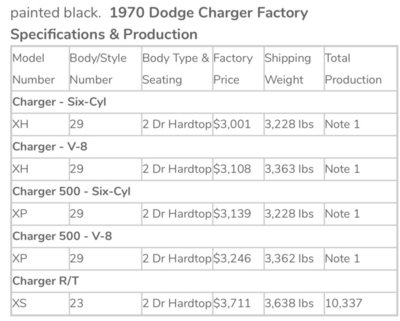

Even that Charger one is a mile off.
My car was stock, not a thing different when I first weighed it. 3660 lbs. I did a 440 swap and checked it again, 3751. Just last year I weighed it after adding frame connectors, torque boxes, bigger torsion bars, sway bars, etc: 3940.

Look at the Charger list. For a Charger 500 it lists 3362 lbs for a Charger 500 V8. That is what mine is. Mine weighed 3660, a full 298 lbs more. Why is that?
It is because those numbers are not accurate. They do not include the added weight of options such as A/C, P/S, A/T and any other thing.

The problem is, everyone scales their car differently. The two main variables are the accuracy of the scales and the amount of liquids in the vehicle. Throw in any extra baggage, and vehicle weights get inflated pretty quickly. Step away from stock components, and numbers jostle around even more.

KD's right. Those advertised weight specs vary from data point to data point by as much as 100 - 250 lbs.. It's like asking a woman how much she weighs... you never get a true number. Until you plop yer *** on the scales and get a true weight +/_ weight scale accuracy, only then can you backup your opinion with valid data of what YOUR CAR ACTUALY WEIGHS... not some advertised nonsense.

Published shipping weights are utter fantasyland. Most small block a body's weigh around 3400, big block b body's around 3800 up. A small block won't be more than 150 lighter. My best friends 70 340 challenger weighs 3600 plus, my manual brakes, manual steering, no air , bench seat 69 runner weighed almost exactly 3700 , stone stock on a racetrack certified scale. (Big block, 727).
Most people who read shipping weights, then weigh their car are seriously disappointed.
