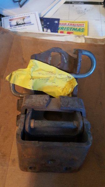

Yep.. ZERO issues !

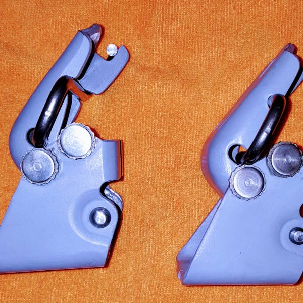

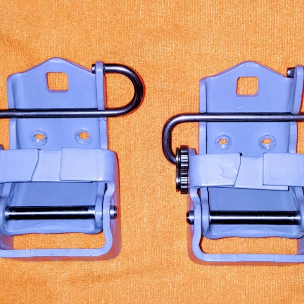

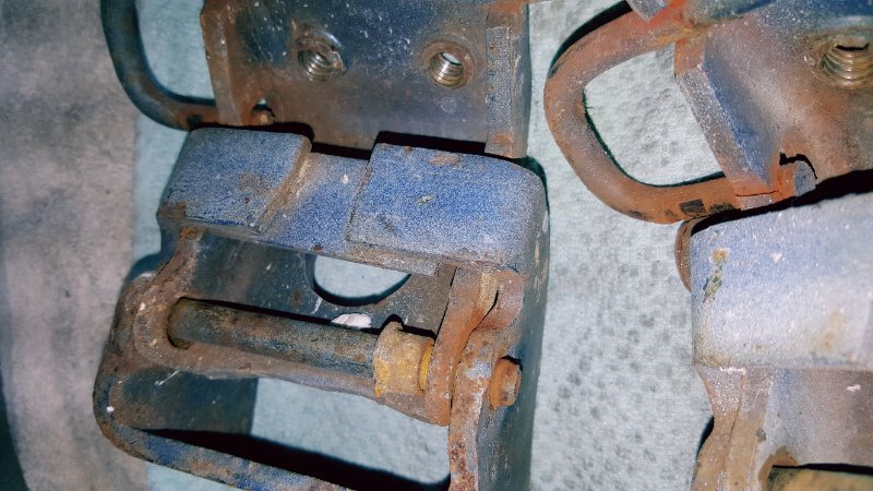

Here are some photos of bushing kit repairs after a while and the bushings fall out. I just tossed them in the scrap bucket.
On the right, my completely rebuilt door hinge with oversized pins properly fitted.
Will last longer than 50 more years.

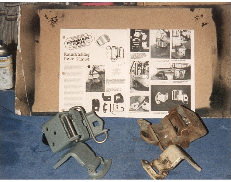

It’s been many years but sometime in the 80-90s I was working on my 67 Coronet and did mine using this article from a Mopar magazine. Does any know who this was in the article?
Looks like it could be RestRick. He sells kits like that.
An oversized lower pivot pin and standard replacement upper bushings and pins.
Doesn't address worn or frozen door checks.
You can email him and ask him.
