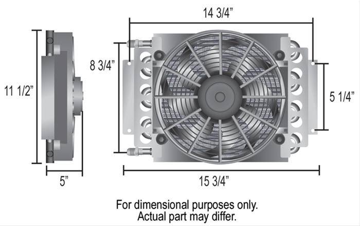

many people run (or ran) fuel thru a sort of trans cooler type deal
like a Derale trans cooler, with a fan assist helps too
mounted in the cool air nowhere near the radiator, exhaust or engine heat
Transmission Derale Electricool Trans Cooler & cooler fan assist der-13700_w dimensions.jpg

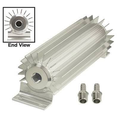

or a heat sink
Transmission Derale Heat Sink Trans cooler der-13249_w $57.95 Summit Racing.jpg
