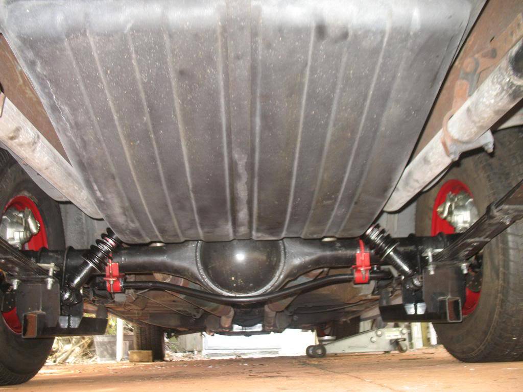

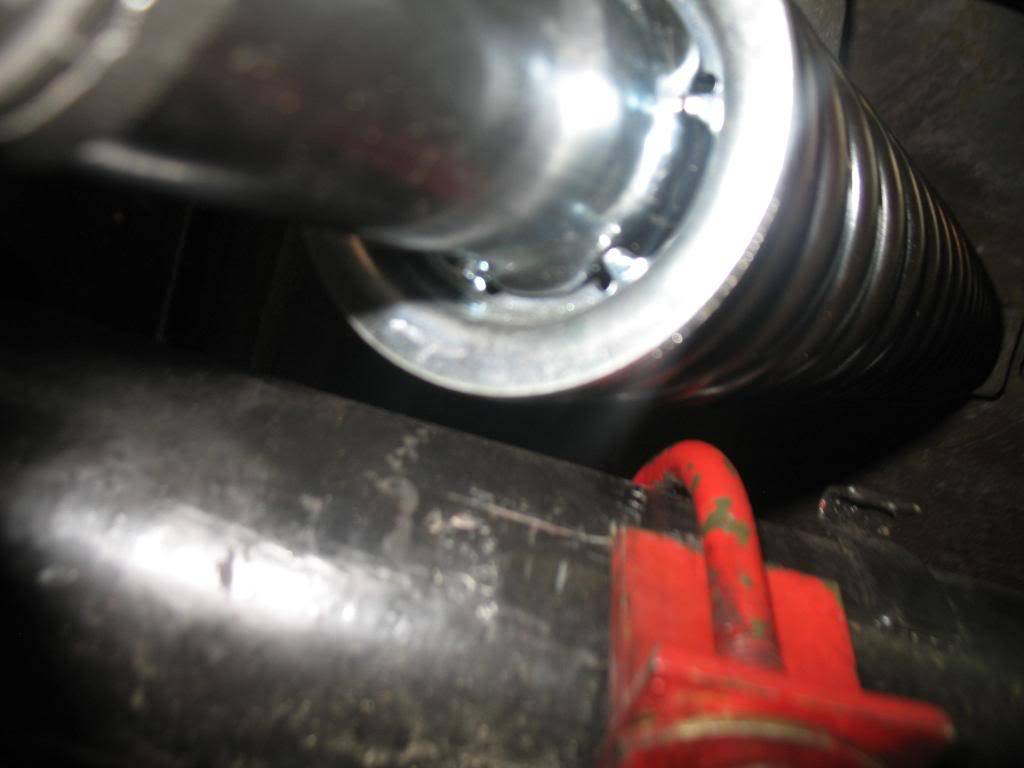

A few quick shots
quick and ez 1 1/2"
Monroe sensatrac's plenty of clearance
