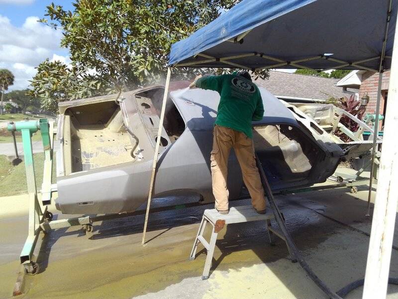

Yes and it is a big wet mess that drys out and then you have a dusty mess. It’s really no less mess than any other blasting.
The water is said to keep it cool so no warping.
They are selling these dustless blasting businesses like it is something special, it’s more of a gimmick.

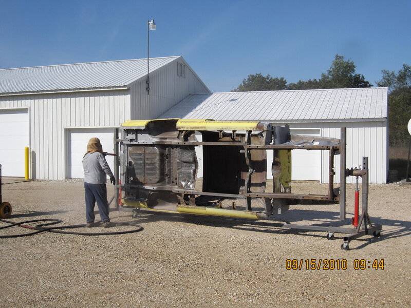

When I had to strip my Belvedere, I had it sand blasted, except for large flat areas. Those I manually striped with a air sander. Really didn't take too long. I also, earlier. had the hood, deck lid, and fenders soda blasted. The soda also has to be dissolved with water, so quick drying is required. My body shell was on a rotisserie for the work. The soda was more expensive and removed only light rust.

Had my car done and will not do another that way! The wet mess dries in the recesses and then is impossible to get out!
Did mine the old fashioned way. My body guy just took his time. Moved from area to area quite often. To be honest took about 12 hours of blasting to compete the entire car in about four or five sessions. Sand blast-clean-prime, sandblast-clean-prime and repeat.

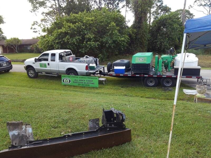

My setup is just like yours, on a rotisserie with the floor plan removed. Not to many people that offer blasting in my area, the dustless blasting company comes right to my house.
When I had to strip my Belvedere, I had it sand blasted, except for large flat areas. Those I manually striped with a air sander. Really didn't take too long. I also, earlier. had the hood, deck lid, and fenders soda blasted. The soda also has to be dissolved with water, so quick drying is required. My body shell was on a rotisserie for the work. The soda was more expensive and removed only light rust.View attachment 993155

It did a great job on the car but the mess afterwards I still have sand everywhere I'm still finding sand in the car too!

I had a guy come to my house and do the dustless blasting with recycled glass/ water. It did a good job but make sure you look into how much "Hold Tight" they are suppose to mix in the water and let the guy know that you know about it, they will often cheat a little on how much they use, it's expensive. I put down a 30x30 tarp and scraped up about 4 -5 full wheelbarrows of sand when he was finished . I think there was still 2 more left in the car,lol. He did the whole car including the inside of the fenders and in the trunk, engine compartment,underside of deck lid, hood. The floors and underside didn't need it, i used a needle scaler to remove the undercoating prior to the car being blasted. I should have done that after it was blasted.Later that day I primed all the undersides of the hood, trunk, fenders ect first because it you get any flash rust these areas are the hardest to sand . I hit all the finished sides of panels with 120 on a da the next day and then primed with epoxy.
