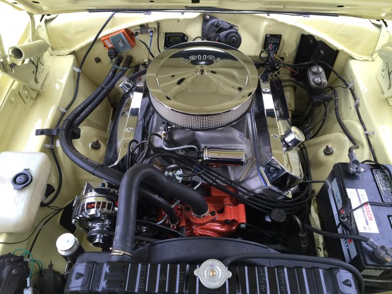

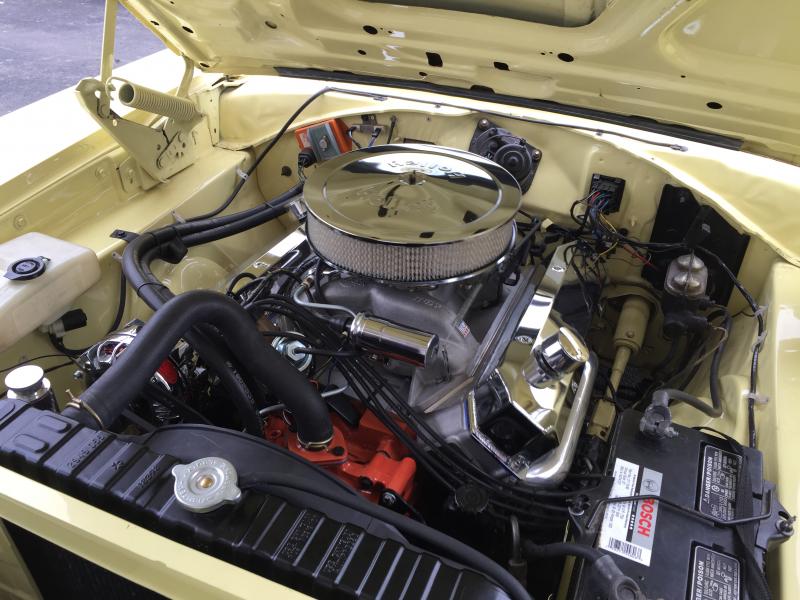

Engine work complete except for dyno tuning. Being sent to a transmission shop this week to upgrade the transmission to take the expected power and torque. It should be done completely in the next two weeks unless I decide to upgrade the drums brakes to disc.

I am using a Holley 850 vacuum secondaries and I have not driven it yet. It is stroked to 500 cid with ported Indy EZ-1 heads and port matched intake. It still needs put on his dyno to tune it after the transmission is beefed up.
