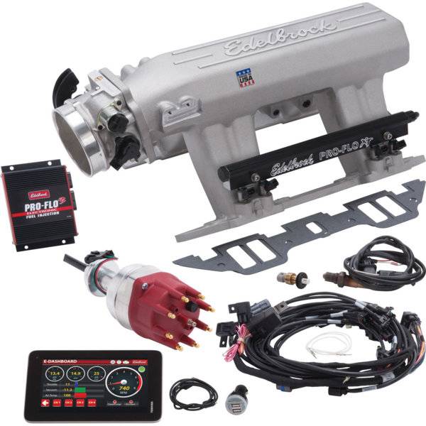

I'm looking at going to a sequential fuel injection system. The Edelbrock Pro Flo 3 and 4 use the tall plenum intake with direct runners to the intake ports. I like the looks but I'm not sure it'll fit under the hood of my 68 Charger. I'm running a 440 with stock heads. Any thoughts?
This is the Pro Flo 3. Says height is just under 10 inches.

Even with the conventional intake, drop down air cleaner, and power-bulge hood, the hood just barely clears on my 69 Coronet R/T. There is more info for the type you like on edelbrock forums.
I have pro flo 3 on the 440 in my van but I'm running the 4 barrel looking one. Barely fits under the doghouse. Had to do alot of measuring and spacer to get the air cleaner under there
