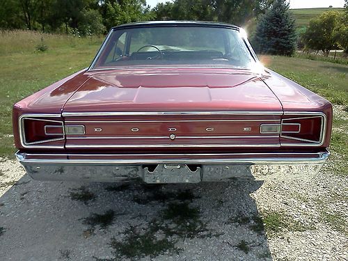

They certainly look different. Note the key lock location...
1967...

Physically, they will swap, but then your taillights and extensions are different between the two years, plus the reverse lamps are on the decklid for '66 and in the bumper for '67. Far more differences than most people realize. The quarters are also the same dimensionally, but have different contours, which are apparent side-by-side.
Not even close, unless you make it all one year of rear. Back-up lites, extensions, tail-lites, decklid, bumper.....
