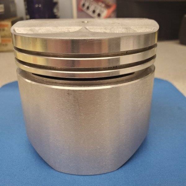

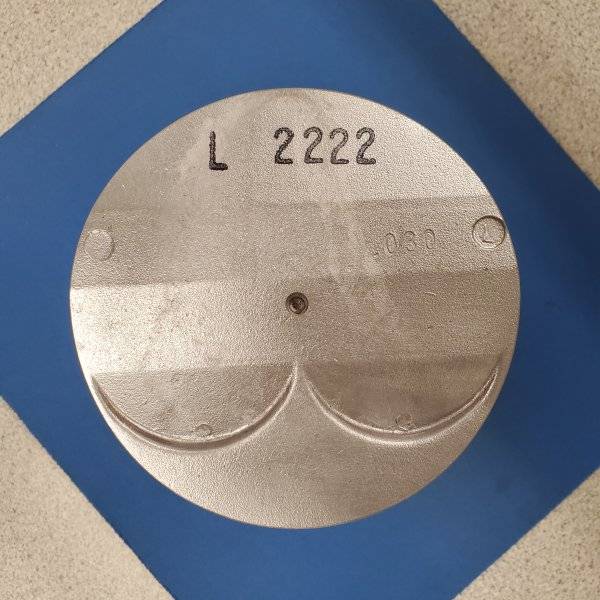

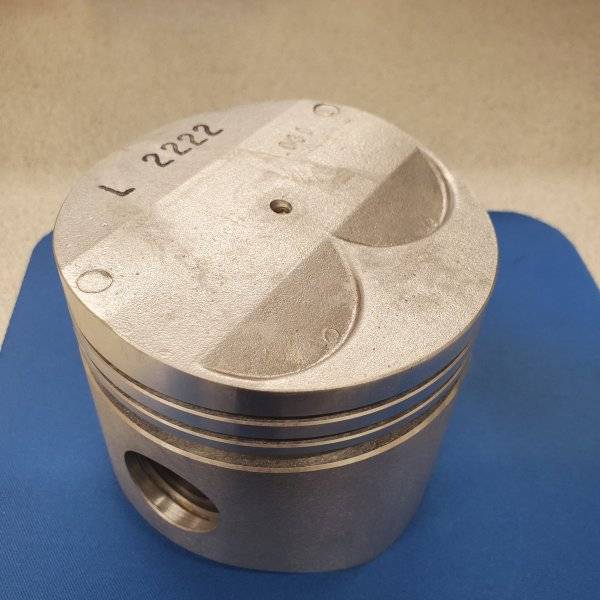

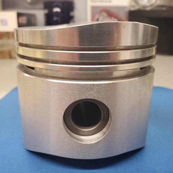

Our 273 10.5:1 pistons #L2222-8. Still a popular seller for us and we have a couple reground, original profile solid lifter cam/lifter kits in stock.

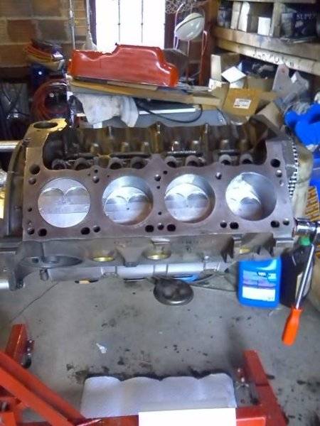

Those are nice pieces. That's what I used in mine and have recommended them to dozens in these forums for their 273 builds. The machine shop was very impressed at the quality and consistency of these.
