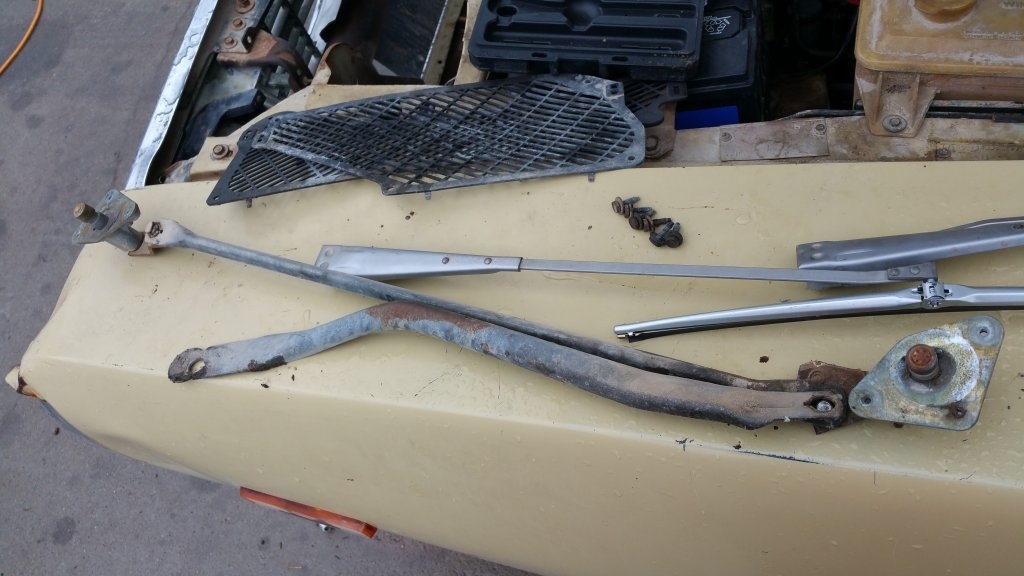

So my passenger side windshield wiper quit working in m 73 charger, and then soon tell drivers side wiper quit as well. I pulled the assembly out and discovered the bushings were shot and the linkage had fallen apart. My question is, are all 3 bushings the same? And does anybody have a Napa part number? Thanks.

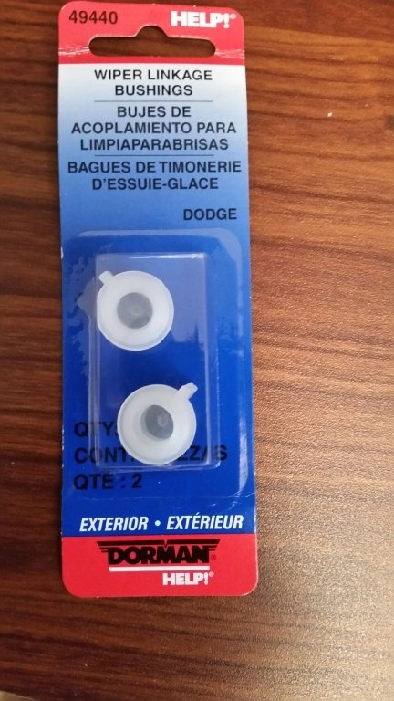

If you are talking about these, I got these from Oreillys.
I found some at napa, and installed them. My wipers work again! Thanks.
