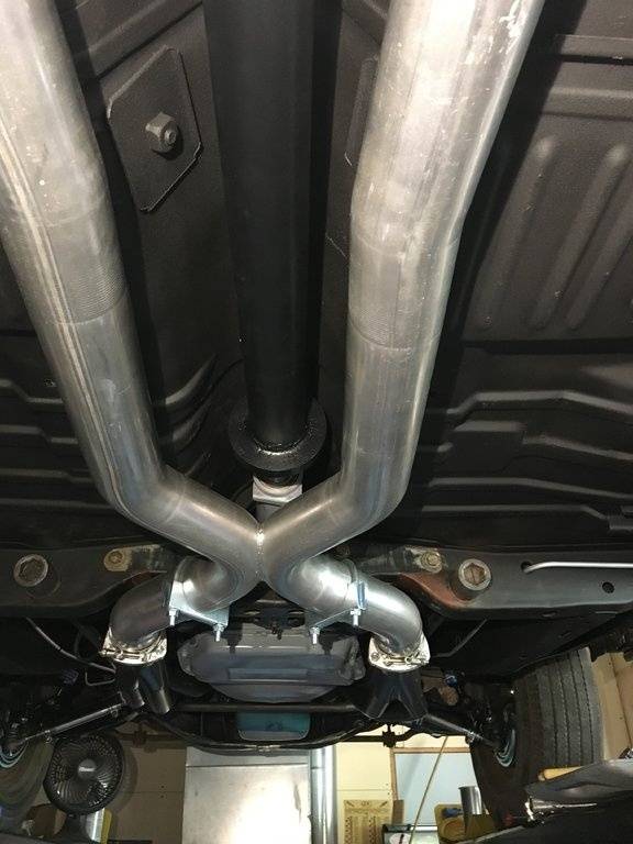

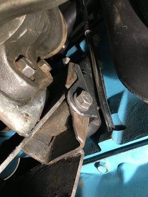

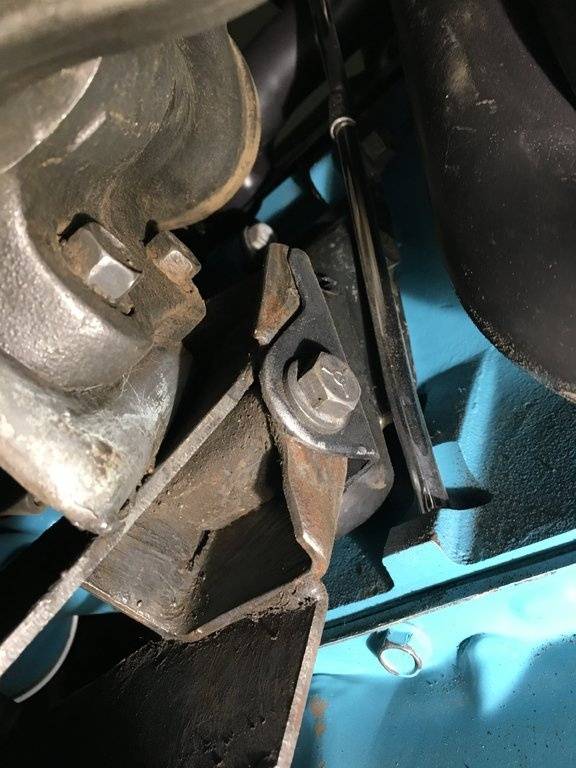

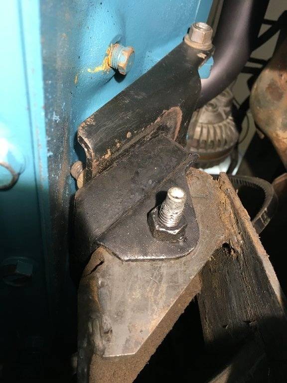

I'm not sure if these mounts are installed correctly.

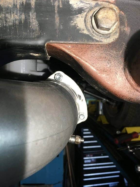

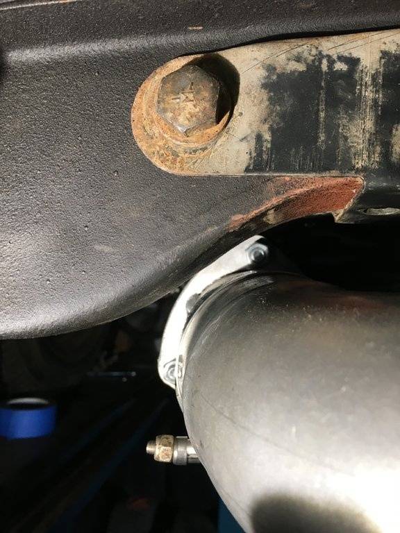

My left header is only about a 1/2" from transmission cross member, right side has more room.

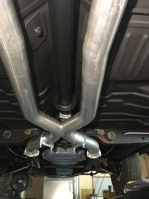

TTI Exhaust isn't perfectly centered on car.
The bolts on the rubber isolator are touching the block also.
That's what makes me think something isn't right.
From what I can see, looks right. The brackets pretty much will only fit one way and same for the rubber mounts. As for the studs touching the block, they are usually very close and I don't like that either and will shorten them. And as long as the headers and pipes have clearance without having to beat the snot out of them, I'm happy lol
