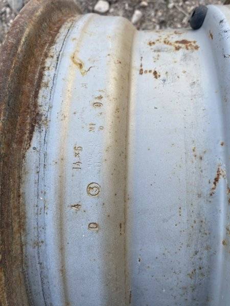

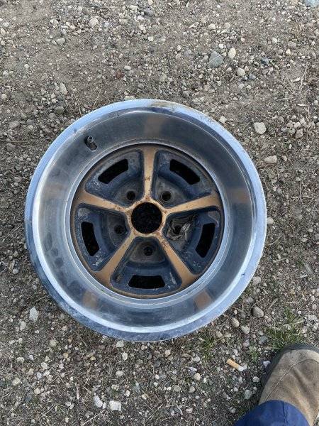

Can anyone identify these wheels? Are them mopar? 4 1/2 lug pattern.
Those "Magnum 500" style wheels were made for all three (maybe even all four) major US automakers at one time or another.
I don't see a pentastar, but check by the valve stem hole.
Best to measure the lug spacing.
That looks like a mid seventies Ford/Mercury Magnum 500 wheel. Mostly found on Torino's,Cougars and Rancheros.
Of course ford wheels are also 5 on 4 1/2, so they will work.
The non-chevy gm magnums usually had deep/wide outer center flanges, making them somewhat easier to spot
The chevy ones however looked just like ford/Mopar wheels but of course were 5 on 4 3/4 or 5 on 5.
I agree with chargervert that those could very well be Ford rims.
You can safely use them on the back of the car, but you might not be able to use them on the fronts as the center hub/grease cap on the fronts may be taller than what the center register of the wheel stands out and doesn't seat all the way down to the hub...
I don't think so.
The ford ones I have take the same center as Mopar wheels.
There was a different center used on some ford wheels.
No center registers on Magnum 500 wheels.
The grease cap area does stick out past the hole for the cap, but the Mopar style bolt in cap fits over and covers it.
The "other" ford cap spring clips in and does not fit with the Mopar spindle/brake drum.
Regular Ford wheels center hole is smaller than mopar. Put a pair on my 8.75 and ran lugs down with an air gun. Had a hell of a time to remove them.
But again, Magnum 500 wheels, regardless of who they're shopped for.....have no register holes.
