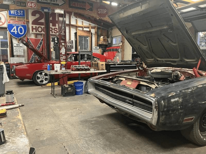

No screw. Neither of these cars have screws holding the ECM plug in place.
The red one is the only car that has this issue. The car in the foreground (Jigsaw) has never failed to start.
