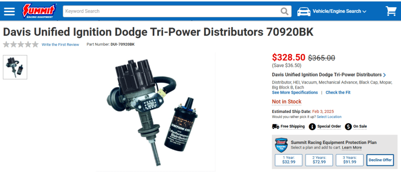

Oh, and the reason that I have saved the ECMs that are absolutely known to be dead? I've seen some guys gut the insides out and mount a GM HEI module inside. This gets you electronic ignition that is reliable and looks similar to what you already had.
I've thought about this option:
I almost used one of those in my build, but I've read a few reports of these failing. Could be faulty install, but I didn't want to spend that $ and take a chance, so went with Firecore instead and kept the Mopar Chrome box ECU.

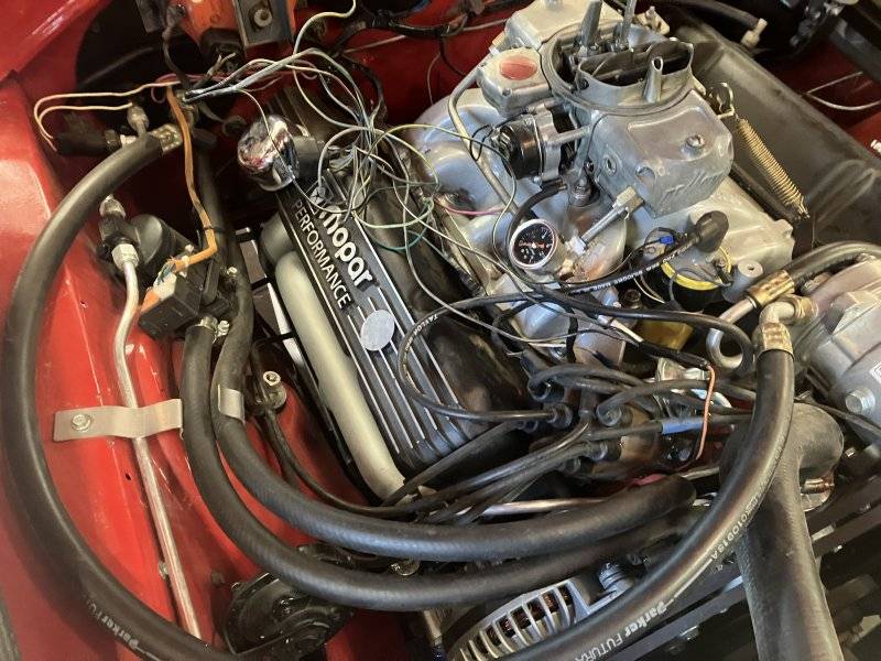

I may have it figured out for now.
As always, my day starts much later than you guys. I am still online when east coast guys wake up.
I got out here and started to tinker.
* Fully charged battery, ether down the throat, Mopar Performance.08
ohm coil, orange ECM that worked in Jigsaw. No spark.
* Change back to previously used Accel coil. No spark.
* Mocked up spare new ECM plug and harness. Fire!!
From this:
To this:

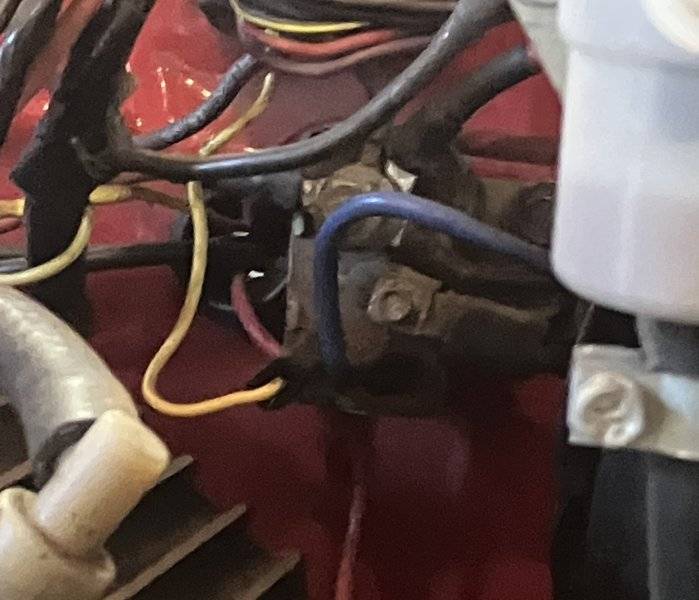

I didn’t cut anything. I just disconnected the wire to coil positive and the blue/yellow to the ballast resistor.
It is a bit of a rat’s nest but it worked for a test.
The orange box of doom. You can see I “jumpered” the wires to the right side of the ballast resistor. Oddly, the diagram I got from Mopar Performance showed the following:
Their depiction of the starter relay doesn’t match mine.
They show the blue/yellow wire going to the relay.
