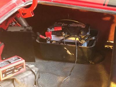

The battery is in the trunk, the trunk has a light in it. I can still open the door and try your suggestion just to take it further.
It is certainly possible that there is a draw somewhere other than the trunk lamp.

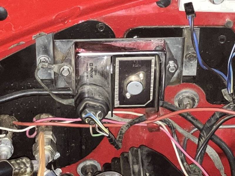

I have a ground on the ECM standoff bracket....
It attaches to the rearmost intake bolt. I've even grounded it to other points on the firewall.

Lol, all it takes is a regular test light probe, one end on disconnected cable and probe end on battery post.
All of you would be surprised with a little moisturized crud on top of battery leaking voltage down to ground. I’ve seen almost 1volt leaking down.
^^^^^^^. Very true. The crap in the atmosphere settles on the battery & can certainly be conductive, especially with moisture & high humidity. This could drain the battery, but this would proably take days or weeks.

Surprised? Well I was surprised tonight when I did just what you mentioned. Randy posted a video of it where a guy put a test light on the negative terminal and the other end to the cable. MINE lit up. Yeah...I was surprised since I had no idea that a negative terminal could power a light bulb. My electrical knowledge is really basic. I am almost embarrassed to admit how little I know of it.
For me, mechanical things are practical and real while electricity is invisible. I have a hard time grasping what I cannot see.
I tested the voltage last night and got a reading of 12.3? volts, I don't recall exactly. Tonight it was 12.36. The ground cables are disconnected. This showed that while voltage is below spec, it didn't drop off with the battery disconnected so I have more work to do.

You could pop one fuse out at a time to id the problem circuit.
I recall a similar problem long ago...with the test light trick if you start pulling fuses you'll find the culprit. I think...
Circuit isolation will help you diagnose the draw. (what circuit is causing the issue. If you pull the accessory fuse and the draw goes away, you know it's in that circuit.
So, reverse the method... Pull all the fuses & briefly install one at a time.... If with all the fuses pulled you still have a draw the draw is on an un-fused circuit, also there could be draws on more than one fused circuit so if you pull one fuse at a time but the light stays on because of the second draw you won't know that pulling the first fuse had any effect...
And yes, you want to temporarily install each fuse, don't quit when you find your first draw.....

Great idea. I'm about to put that to the test.
In 2 days, the battery went from 12.56 to 12.47 with the negative cable disconnected. The battery is at least partly to blame. That Interstate battery still reads 12.66 after a month of sitting.
It gets weirder and weirder. I pulled all the fuses….
I got this.
I pulled the trunk light bulb and the fuses from the auxiliary fuse panel.
I disconnected the “CrackedBack” relays and fuses.
What is left? All the fuses are pulled so what is UNfused?
Ignition switch.
Headlight switch.
What else?
In 2015 I eliminated the ammeter and ran the alternator charge wire to the stater relay. To get power to the inside, through a fusible link, I ran a 10ga wire through the bulkhead connector. That goes to what the service manual calls a welded splice.
From There it goes to the ammeter, ignition switch and headlight switch.
Back when I installed this “CrackedBack” headlight relay setup, I had trouble with the headlights staying on no matter what the switch was doing. It turned out that the 1970 Charger uses a “concealed headlamp relay” and mine was leaking trace voltage. I replaced it with a 5 pin electronic relay. I seem to remember the dimmer switch had trace voltage too, I’m not sure.
I pulled the 10 ga wire that feeds power to the inside and the test light showed NO light. It is isolated to that circuit. More in a few minutes…,
