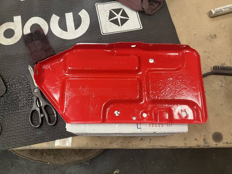

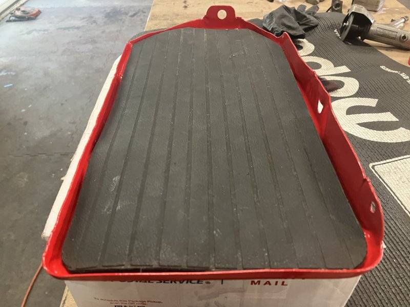

The traditional engine bay setup uses a thin gauge battery tray and support bracket. This was sandblasted, primed and painted....

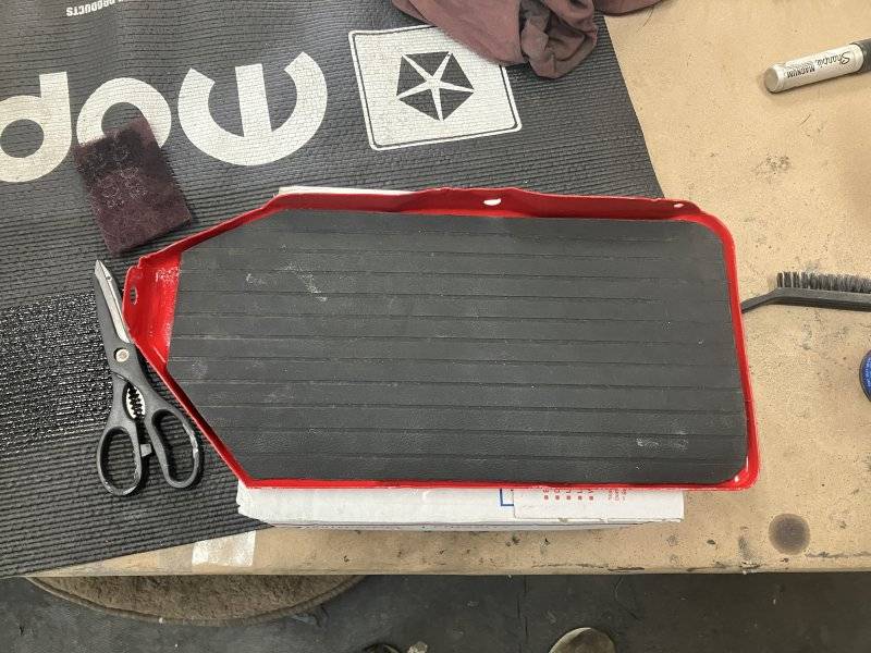

I cut down a flor mat to use as a pad.
I'm going to reuse the trunk mounted battery cables but shorten them. It looks like the parts used to mount the battery in the stock location weigh about 4 1/2 lbs total. This means that when you look at the 18 1/2 lbs that the trunk mount stuff is put against the 4 1/2 lbs for the stock location, moving the battery to the trunk adds about 14 lbs.

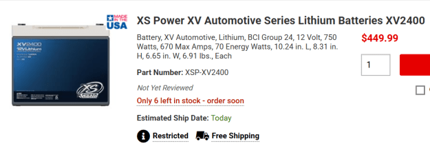

When I replace the battery, I'm strongly considering this Lithium battery:

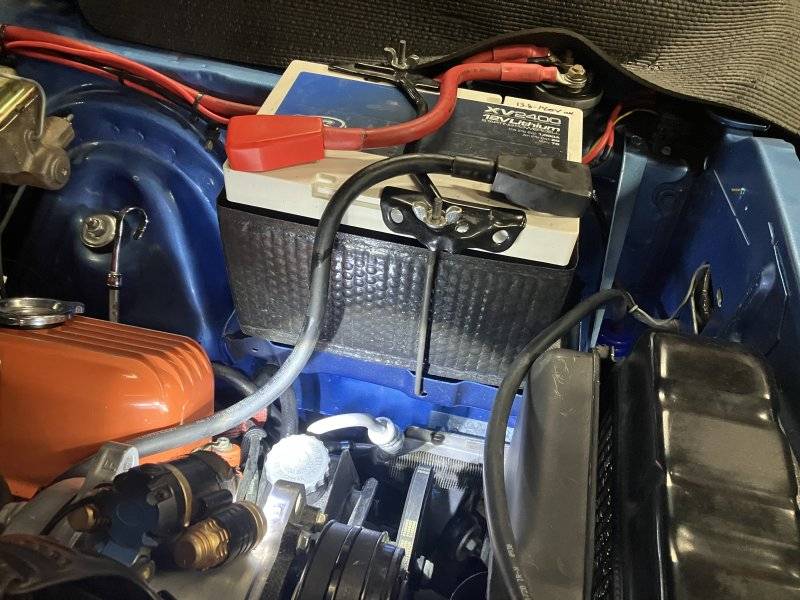

FBBO member 68SportSatellite has one in his Plymouth...
It weighs 7 lbs. My battery weighs 40 1/2. There is 33 1/2 lbs of weight to lose right there while getting much faster cranking speed when starting. 33 1/2 plus 14 means 47 lbs off the car by switching to a lightweight battery moved back to the stock location.
