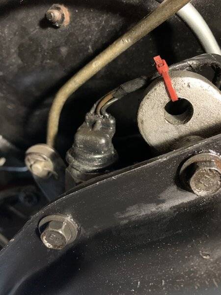

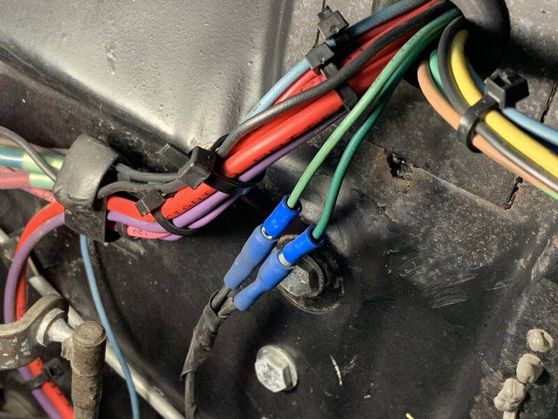

Last year I bought a 68 Charger that was redone. I was crawling around this thing today researching gremlins. There are three wires coming off the NSS, one brown and two black that are wrapped in electrical tape. I can follow it up the firewall to the top and viola, no brown wire! No wonder the car will start in any gear!!

Not quite sure what I'm going to do here. The other two wires are for the back up lights. The car was rewired with a Quik Wire kit, not a proper wiring harness. There is no starter relay in the engine compartment unless it’s on the starter itself. Otherwise it’s under the dash. Is anyone familiar with the Quik Wire product. There’s a couple other wiring issues to sort out.

If you've got a 68 with that 3 prong NSS you have a later trans. 68 had a one post NSS. It is probably grounded somewhere? Or you have the wrong switch.
My 72 had a single post NSS (which should of had a 3 prong) and I thought what the?!? Then I realized the trans was from a 68.
Is that a cam bolt washer zip tied to the neutral safety switch wiring?

He should still be able to run it up to the starter relay if he's using a factory one...
There is no factory starter relay unless it got moved somewhere. Otherwise it would have to be inside the Quikwire box.
